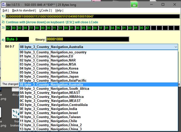

Hey everyone, I'm new to the forum and apologise if this has been asked before. I'm in New Zealand and bought a 2014 Golf 7 1.4tsi wagon with r-line kit. The car is a Japanese import. I'm in the process of trying to change the radio and navigation to work in New Zealand. I have managed to sort the radio out but I'm having trouble with the maps. I have downloaded the new maps and tried to install them, but get an error that says ROW doesn't match JPN. I have the Discover Pro radio. My question is this... does anyone have screen shots of their 5F long coding that displays the label for each bit under each byte? For some reason I can't see the details and information for my 5F long coding. If I could see the options for the bytes, then maybe I can ensure that I have the correct bits selected.

PS: you could try changing Byte 3 - but as I said above, it wont work without a new activation code in firmware:
