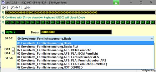

                              nibose: Sounds like you have a mk7 that's post MY16. The good Burghers in Germany that design control modules made some fairly drastic changes to the BCM around this time. The mods started with a change to the "parent" name of many of the adaptation channel groups. After that, further changes were made to the hex09 module in that the software switches in the module's long code were transferred to adaptation channels - making the already huge channel count in the module even larger.
                              That's why the long code on your BCM is a zero-string (i.e. all of the Byte/Bit functions are found in Adaptations -10 in VCDS).
                              So - to the instructions in your post. Here is the pre MY16 long coding helper screen for Byte 2 in the BCM:
                              Notice that the wording for hex05 in my picture above is fairly close to the adaptation channel in your instruction:
                              2. Fernlicht_assistent – Erweiterte_Frenlichtsteuerung – Change to ‘AFS, FLA, Fernlicht ueber AFS’.
                              This suggests that the Byte/Bit instruction further in your instructions has already been accommodated in the adaptation change steps
                              But as they say at NASA "Houston we have a problem". The superfluous Byte/Bit instruction (i.e.
                              Byte 2 – Tick Bit 0 and Bit 1) results in a value of hex03. BUT, the adaptation channel part of the instructions yields a an equivalent value of hex05 (see my picture).
                              Don
