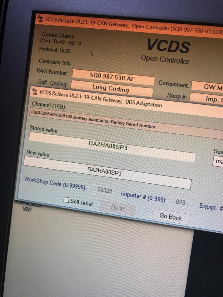

It was done at the dealer so I hope they coded in the new one. I have a VCDS cable. Is there an easy way to check?
Mk 7 R Wagon Wolfsburg. APR Stage 1. Removable towbar.
^^^^yes - it's relatively easy to check: go to the CAN Gateway module @ address hex19, select adaptation-16, search for "MAS06108" and select IDE03256-MAS06108-Battery adaptation-Battery Serial Number. The factory setting for the original battery would have been 1111111111 (i.e. hexFF) - if the setting is still hexFF, then likely the CAN network is oblivious to the fact that the car now has a new battery!

Checked. They did update it. Nice when people do their job
