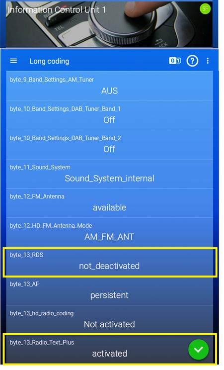

      ^^^^Andrew: just as a suggestion, after you have entered 1024, make sure that you have the highlighted software switches set as per the picture below.
      Then do a complete reset of the MIB unit- with the radio switched-on, press and keep holding-down the ON/OFF knob until the MIB turns off, then turns on again. Then press the TRAFFIC button
        Don
        I can confirm the above setting does activate Traffic Information

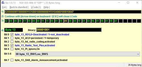

            ^^^^ here's the VCDS screen equivalent (using the "yellow" long coding helper screen from the latest SW version)
            So, set Byte 13, Bit0 & Bit3
              Don
              Thanks for your help got it done and working

                              Did today on a Co-workers Golf 1.4T Mk7.5 via OBDeleven
                              Set Fee based Traffic to: 1024
                              byte_13_RDS to Not_Deactivated ( ie Activated)
                              byte_13_Radio_Text_Plus was already 'Activated'
                              Backed out of Coding to home screen, Press and hold power till it turns back on. Select Traffic after the reset, worked in like 30sec.
