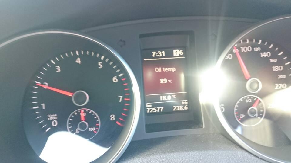

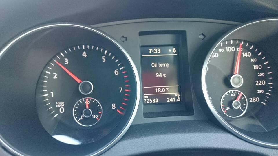

        Just for reference regarding your comments on engine oil temp, here are a few pics i took this morning on a 25 minute commute. All open road so speeds between 70-110kph for 95% of the trip.
        I was in a hurry so i wasnt babying the car this morning - temp didnt exceed 95.
        B9 Audi SQ5
        • #19
          My GTI would sit around 95 degrees in general 60km/h driving in average conditions (say 22 degrees). If I was stuck in traffic, driving quickly or the ambient temp was higher, it'd regularly get as high as 102-103. And if I was driving hard on country roads it'd get as high as 110 occasionally - but it would need proper pushing to get that hot.
          Between 95-105 degrees the oil cooling is limited apparently (as this is the normal operating range); only above 105 degrees is the oil cooling unrestricted.
          Engine oil temps can be affected by many factors, not least of which was the engine run-in technique. An engine that was overly babied may never have bedded in properly and may always run hot and consume some oil.
          If it's any consolation, the latest-gen EA888 in the Mk7 (and in my S3) sits at about 107-109 degrees on a cold night when driven gently!
