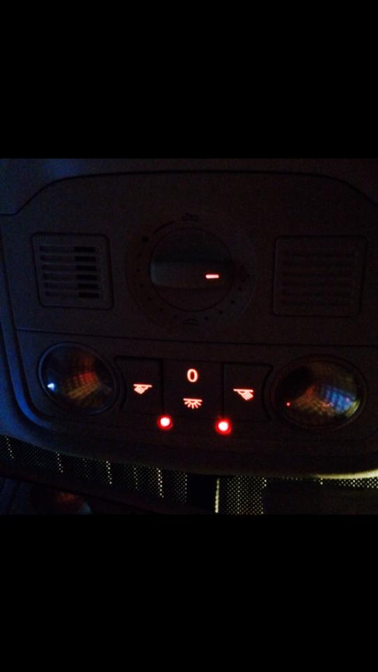

    My console looks like the photo there, except the rear view mirror has sensor for rain& possibly light.
    Manual MY12 RB Golf R | Bluefin Stg2 | Milltek turbo-back
      yeah mine has the rain light sensor just cant see it in this pic

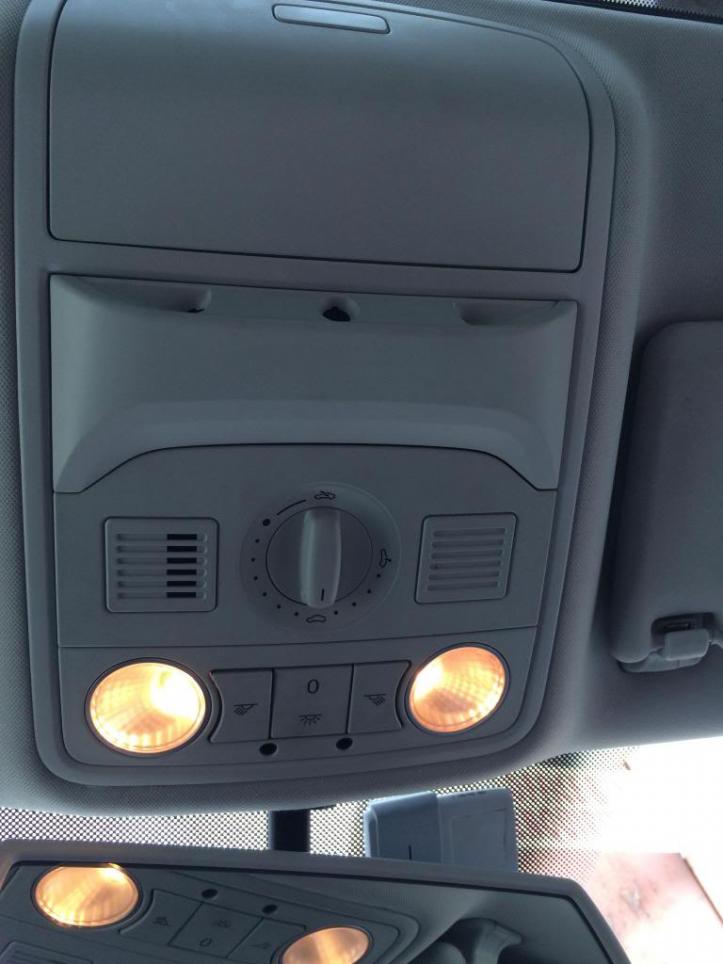

        That's the standard Mk6 w/sunroof overhead console. Mine's exactly the same (except for colour). And no, the sunroof button does not illuminate - it's a shocker from an ergonomics perspective. Amazed that VW let it out of the factory that way TBH.

          Same in the R. Generally the German design is really thoughtful and clever. No illumination on the sunroof dial is a clanger.

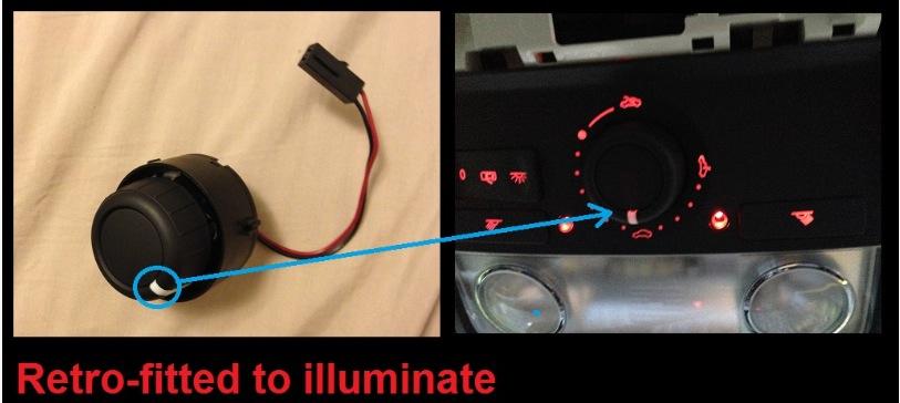

                  update on this thread, I bought a illuminated switch from a MK5 and sure enough its a straight plug and play swap.
                  drop the light console down, squeeze the retaining tabs on the back of the sunroof switch then just slide it up & out, install the new switch in reverse order.
                  The MK5 switch has a MUCH better feel/action to it and you can very clearly feel where the "centre/closed' position is.
                  I'm still yet to figure out how to wire up the illumination in the switch but otherwise it works perfectly
                  when i get some more time i will pull apart the stock mk6 switch and see if the internal cogs (that govern the 'clicking/notches) are able to be changed over from the mk5 switch, given the rest of the design id say this will be as easy as changing the physical grey mk6 knob onto the body of the mk5 switch

                      the MK5 knob has the LED + wiring built into it and if you pull apart the two (mk5 & mk6) the illumination section can be easily transplanted as the mk6 knob can support illumination ( the small "direction" stripe is actually semi transparent ) re the wiring i will tap into the switch illumination for the room/reading lights, just didnt get a chance to pull apart the light assembly yet.
                      but the big improvement has been the tactile feel of the mk5 switch as you can now clearly tell where the center position is

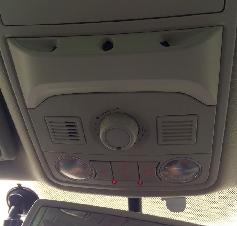

                        tapped the illumination circuit

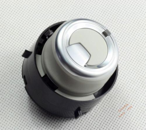

                            Just found this as well:

                              @lucas_R i bought the switch off ebay its just a standard mk5 switch ( make sure when your purchasing one it has the two extra wires coming out the back as thats the illumination
                              i pulled apart the MK6 knob and yes it can be illuminated but you have to put the guts of a mk5 switch in there and you still wont be able to tell properly what position it is in due to the 'notches' on the mk6 internals
