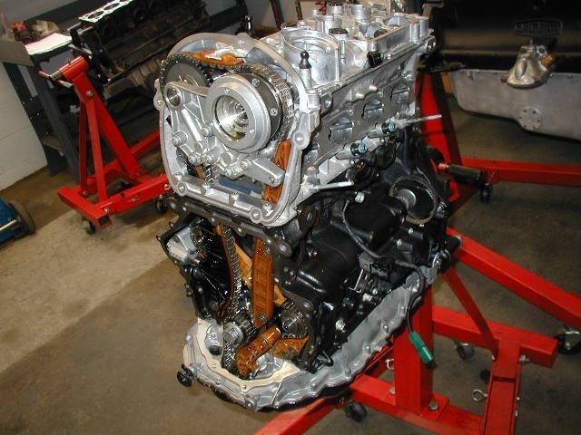

    MK6 gti doesnt have a timing belt for starters . Do a search there is a thread on water pump failures on mk6 gti's

      This is a mk6 gti not a Golf R , they dont run a timing belt but chains :

          Perhaps the workshop in question, was considering replacing the drive belt for the water pump?

            Agree with umainaa. They might be talking about belt for the pump. If not get the hell away from that dealer or mechanic they otherwise have no clue about Volkswagen cars.
