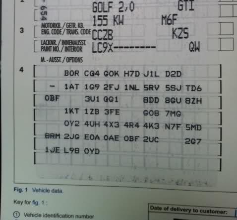

    just picked up my new toy.. 2010 GTI VI
    I was just curious to know if anyone had a list of the 3 letter option codes and what they mean?
    Keen to know exactly what options mine has
    Have all of the paper work but it just lists loads of 3 letter codes for the options and I havent a clue what they mean

    Welcome to the forums.
    There is no definite list of option codes that I'm aware of.
    Within NADCON there is Car Configurator page, where along with the option codes, are an plain english "description" of the option, although it's usually not more than about 5 words. If you don't know what NADCON is, check out the first post of the How to track the car you have ordered? thread. But given the year of your car, I presume this means 2nd hand.. and therefore a dealer isn't going to be able to help you there.
    Additionally, you can pay for an hour's use of the official VAG "Electronic Repair and Workshop Information service", otherwise known as erWin. If you have your VIN, you can put in that into erWin and do a "Individual vehicle information" search and find out exactly what components were used... but this includes literally every "pr code" that goes into the car, not just the options - so that may give you far more information than you wanted...
    The other alternative is to just list the option codes you have, and forum members can detail what they are....

      here's the codes:

        Try this link:
        VW Group Option Codes Decoder
        You just type in the 3 digit codes with a space between them and it will spit out all the factory fitted options.

          Excellent, just what I was after
