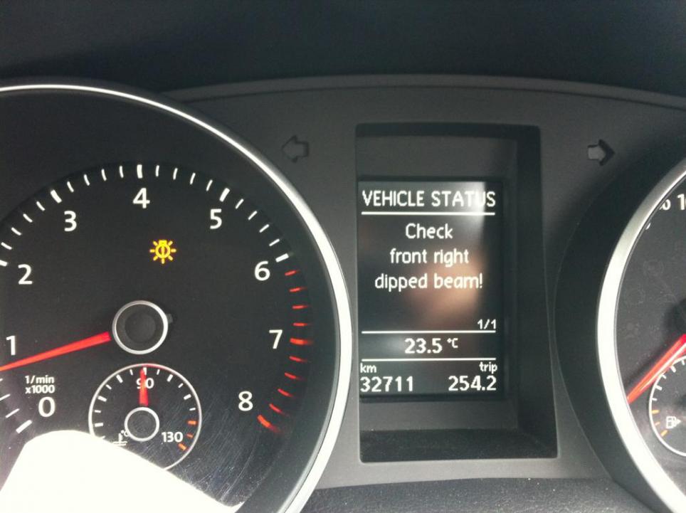

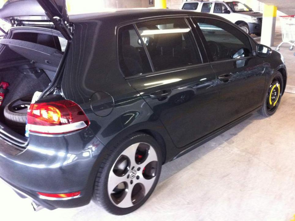

    Bloody Friday commute home....got a flat tyre on the main road outta Canberra. I only drove 500m when I could feel the car was sluggish (even checked handbrake was off).
    Interestingly, the TPS did not warn me at all. I've RTFM and it states I should've got a warning. Last weekend, got all the tyres to 38psi and reset the values by way of pressing the button in the glovebox.
    Anyone else been caught out?
    The screw hole is repairable but the Conti CS3 maybe stuffed due to their soft sidewall. That's ok...after 35,000kms and two track days, they are scruffy around the edges.
    Got this warning not long after too! And yes, the bulb has blown;
