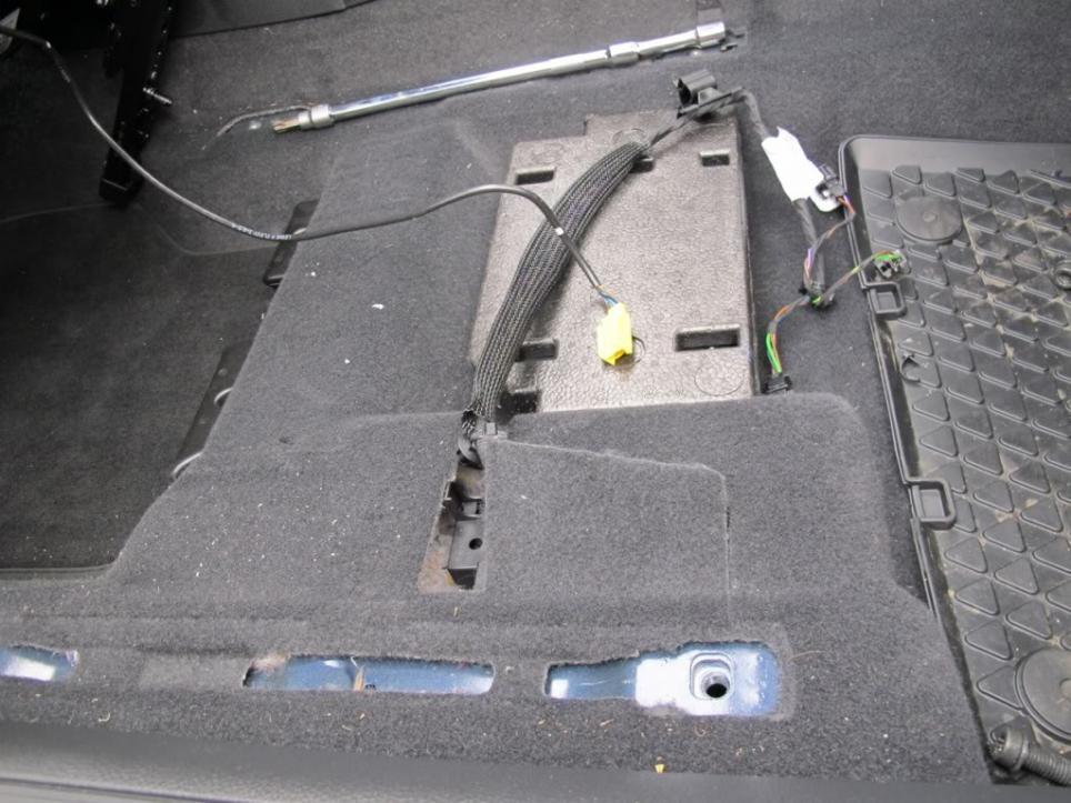

    Most of the cables are connected with clips on the underside of the seat, however mine had a rouge cable which passes through the meshing and plugs into a socket on the floor:
    There was a cable tie on each end of the webbing which a clipped off to get the plug through. Easy enough to replace later

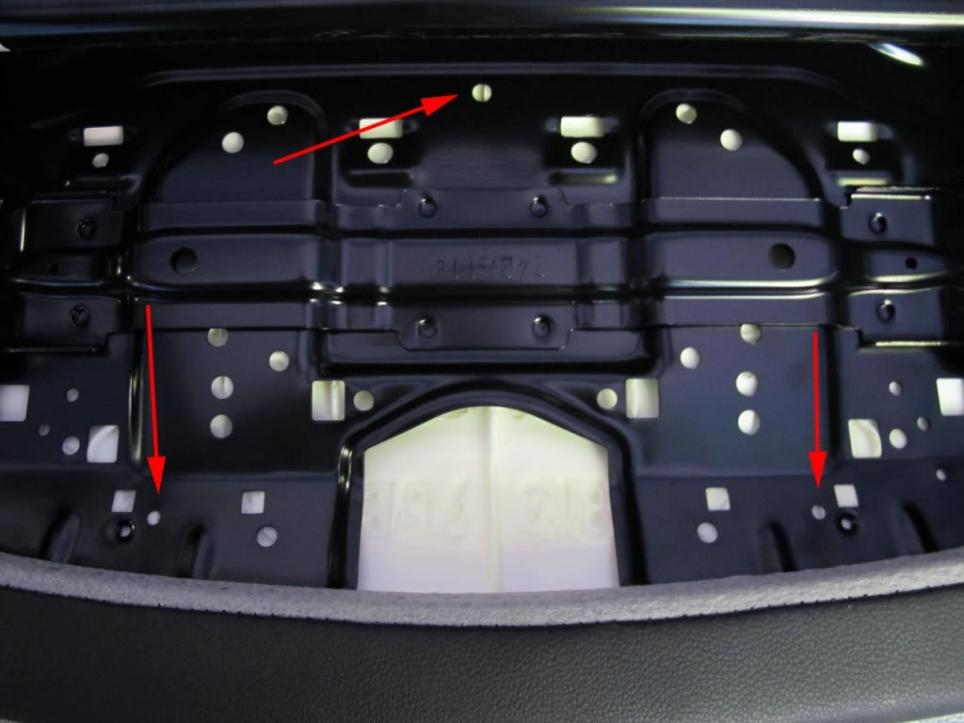

    So with the seat out and flipped upside down I had a look and picked these mounting points:

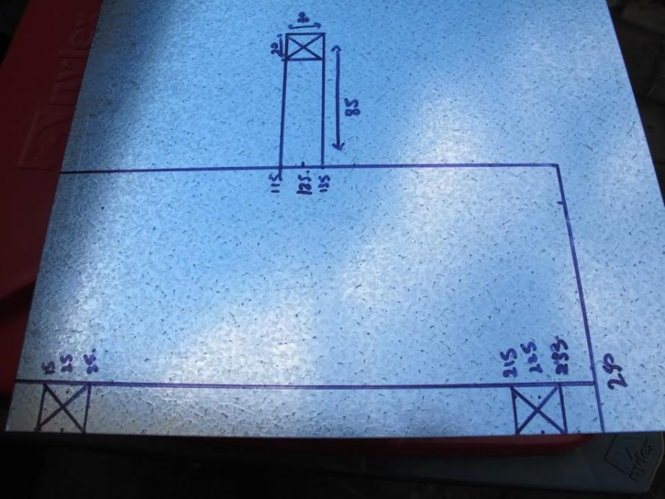

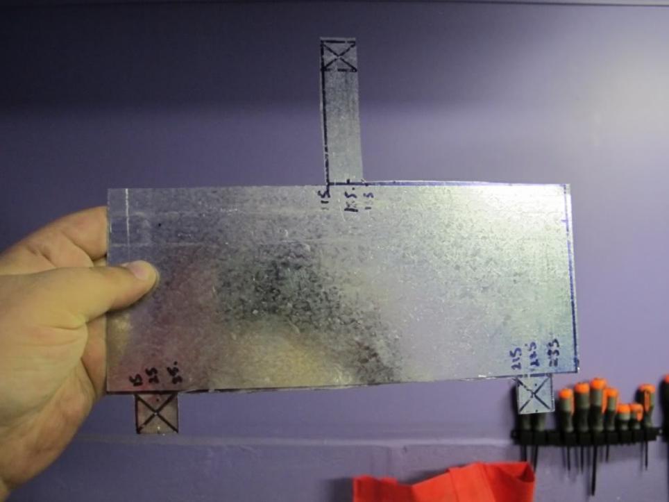

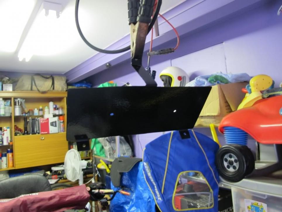

    A little measuring and a little cardboard cut to size and I had a bit of a template mocked up and marked out on some .9 Gal.
    For reference if you can't read my markings:
    * They main body is 250 x 105.
    * The two front tabs are 20 x 20 inset 15mm from the edges, which makes the centres exactly 200mm apart to fit the front mounting points.
    * The rear piece is 85 x 20 (including the 20 x 20 tab for mounting). Conveniently this is dead centre.
    I started with a Dremel but quickly gave up and whipped out the jigsaw (after a trip to Bunnings for some steel blades). This is the rough shape I ended up with:
    A bit of a clean up of the edges with the Dremel and a grinding stone to remove the sharp edges and round of the corners along with some bending and a quick coat of black paint to make it look more presentable left me with this:

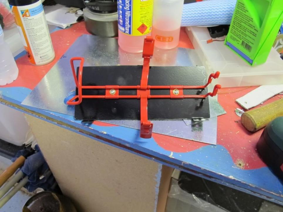

    From here it was a matter of bolting up the extinguisher mount that came with the bottle I bought:

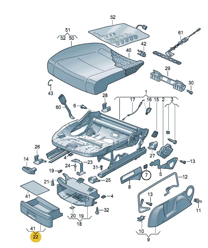

      Won't that block the underseat drawer (for those of use who have them)?
      Resident grumpy old fart
        If the drawer is in the front.. Then yes. In my case I don't have any so it wasn't a concern.
        edit:
        I have grabbed out the diagram for the drawer and yes, when it comes to this install it's one or the other since it looks like both options involve rivets.
        You could choose to have one of each and get the best of both worlds.
        I'll have to dig up some prices for a retrofit drawer, ECS have a kit listed, but from my readings in ETKA it seems that the 2012 model gets a different part number on the drawer vs the 2012 models (although the actual frame guide is common across both).
        In 2011 make vehicles the drawer is 1K0 882 601 J
        In 2012 make vehicles the drawer is 5K0 882 601
        Common Parts (full set needed for each drawer):
        N 900 978 02 - Pop Rivet x 2
        N 909 998 01 - Oval hexagon socket bolt x 4
        1K0 881 891 A - Insert for stowage compartment x 1
        The the specific parts for a 2012 model (or a cabriolet for me)
        Left Front:
        1K0 881 547 A - Bracket x 1
        5K0 882 601 - Drawer
        1K0 882 599 B - Guide Frame x 1
        -OR-
        5K0 882 601 82V - Drawer (Titanium Black)
        1K0 882 599B 9B9 - Guide Frame (Satin Black) x 1
        Right Front (although this is where my fire extinguisher is):
        1K0 881 548 A - Bracket x 1
        5K0 882 602 - Drawer
        1K0 882 600 B - Guide Frame x 1
        -OR-
        5K0 882 602 82V - Drawer (Titanium Black)
        1K0 882 600B 9B9 - Guide Frame (Satin Black) x 1
        Of course then the real question is do I want a drawer to put crap in (which might just be handy) or would I prefer/enjoy an under seat subwoofer more
