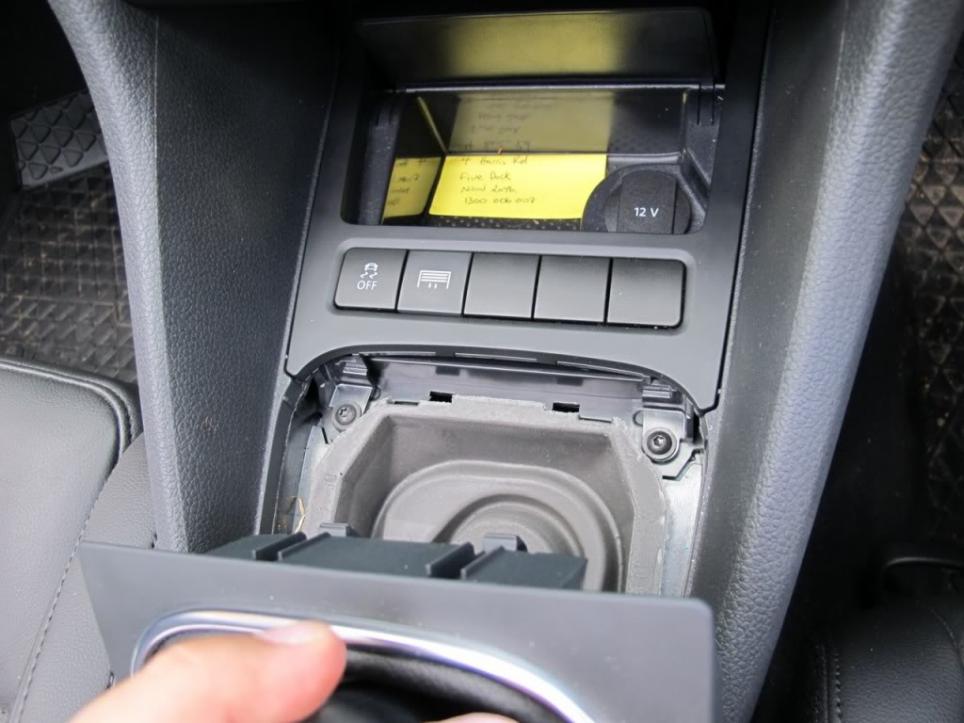

    It's relatively straight forward, pop the plastic surrounding the gear shift and unscrew the two T20 screws so you can pull the button assembly out"

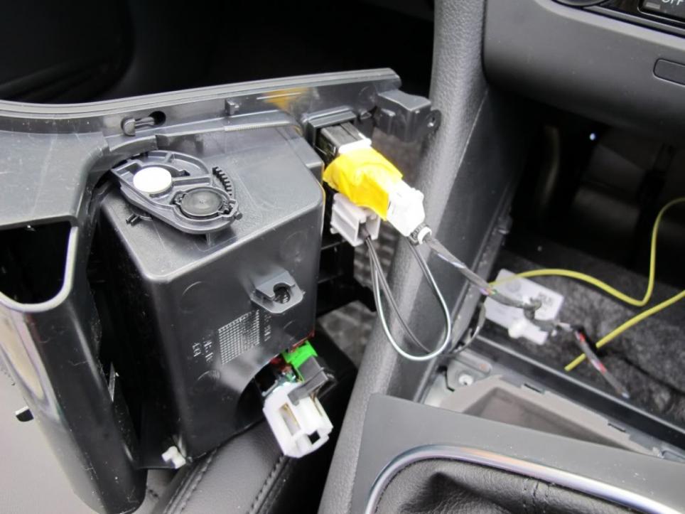

    From there it's a matter of unplugging the two cables and getting the tray out:

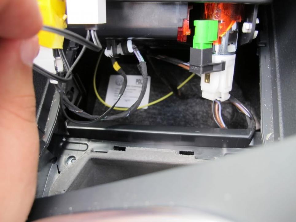

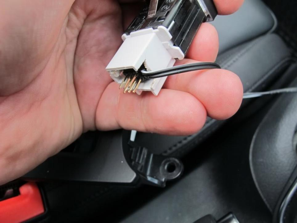

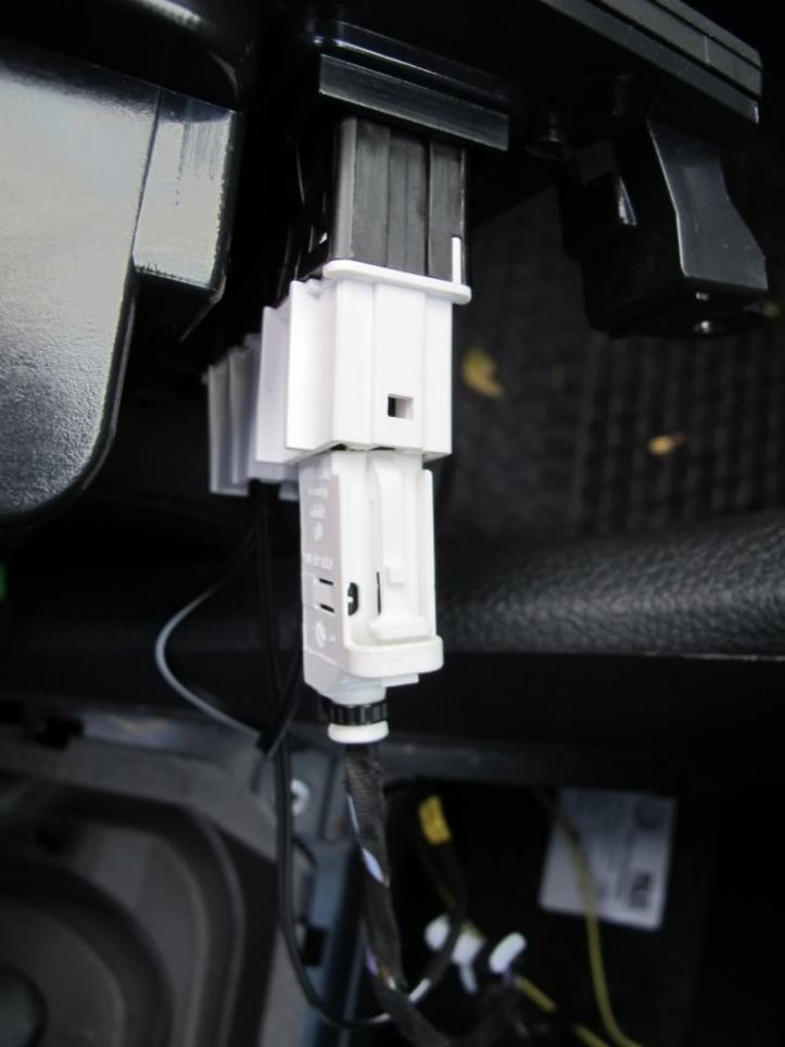

    The new switch piggy backs off one of the existing switches for power to light it up. It uses a little pass through adaptor, I thought the original unit could do with a little notch to let the new wiring out and still let the factory plug fit as snug as possible:
    It doesn't secure itself in unfortunately:
    But a little electrical tape for good measure should solve that:
    If the worst were to happy and that cable were to come unplugged it's only the switch to turn the TCS off so it wouldn't be a major problem, but it looks like it should be secure enough.

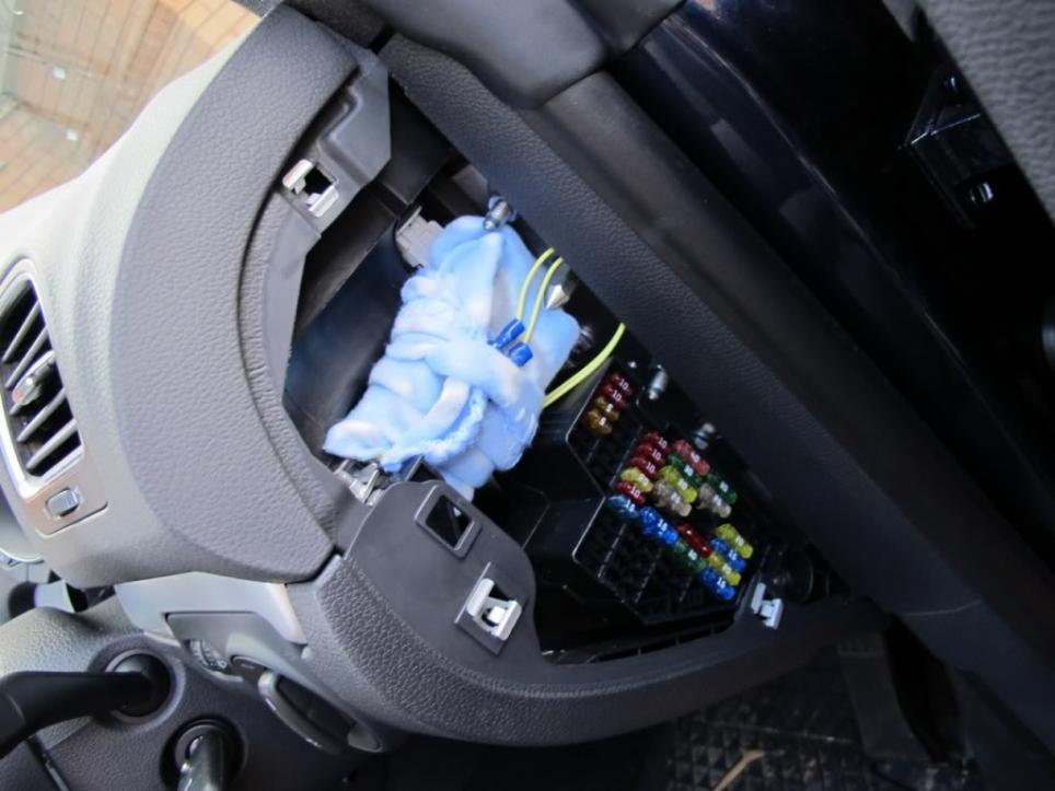

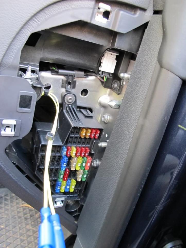

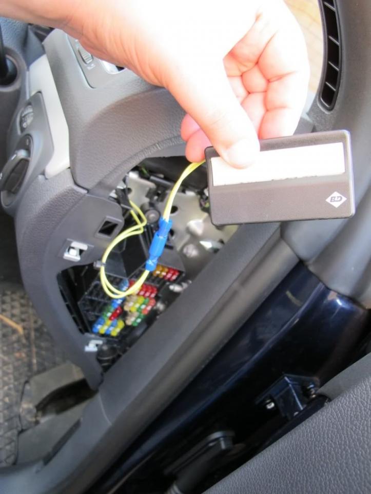

    I decided to mount the remote into the space above the fuse box, this means that it's easy to get at when I need to change the batteries (also means I don't have to hard wire in power for the thing).
    A little creative use of some material off cuts means there won't be any rattling in there. (I'd love to get some of the factory foam stuff to use instead, but this is almost as good although maybe not the professional look.
    The cable itself has a couple of bullet connectors so I can remove the remote at sale time and the new owner can plug in their own remote with minimal fuss. The cable is otherwise cable tied into place to it can't run away.

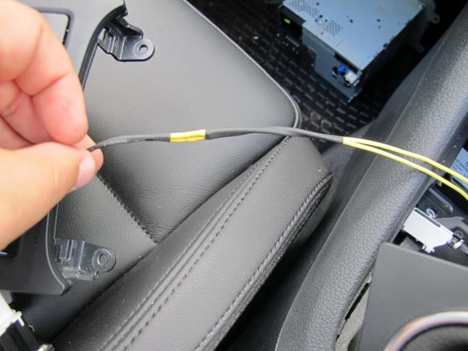

    Everything else is neatly soldered and heat shrunk:

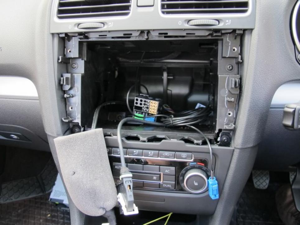

    To get the wire across I found it easiest to remove the radio and first run the cable up to that space, then across behind the steering wheel and into the fuse box space.

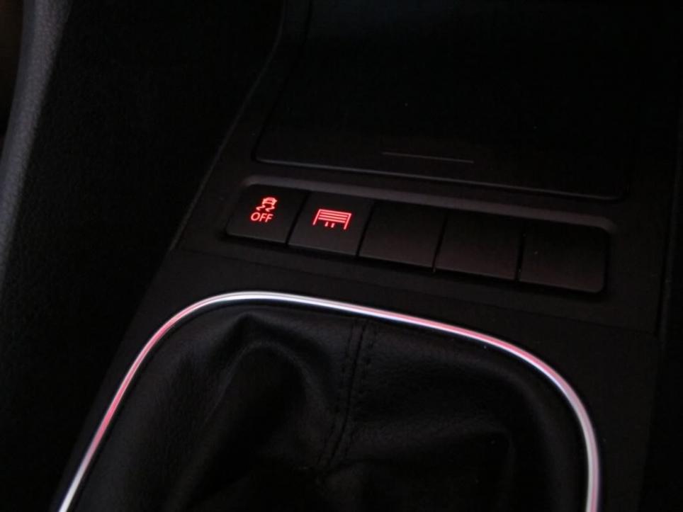

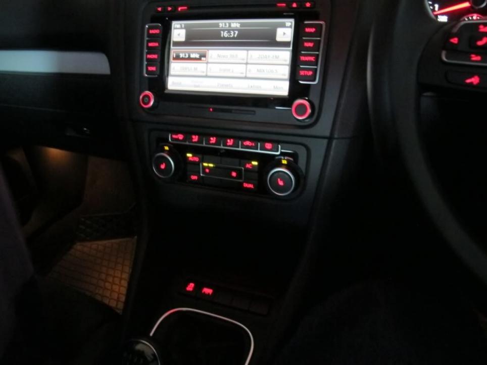

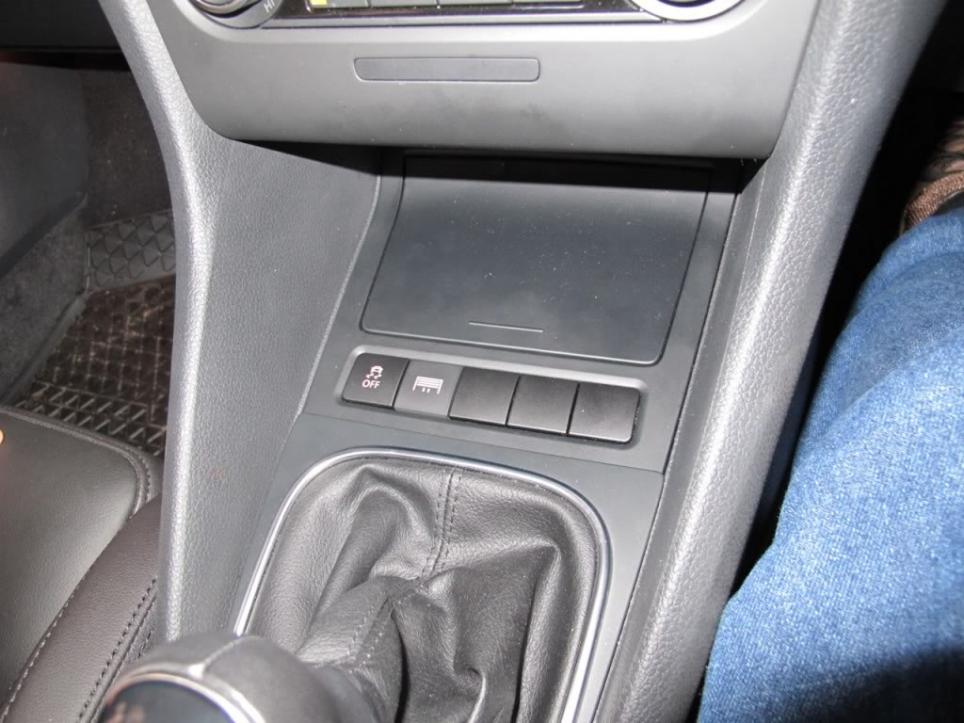

    And here it is all put back together and working, the colour looks a little off in the photo's, but in full daylight it's much closer to the stock button (although still a shade or two off):
    and in the dark it fits perfectly:
    I think a good clean with the products I use will see it match a little closer. In reality I don't think anyone but an enthusiast or a perfectionist would notice.... sadly I'm both
