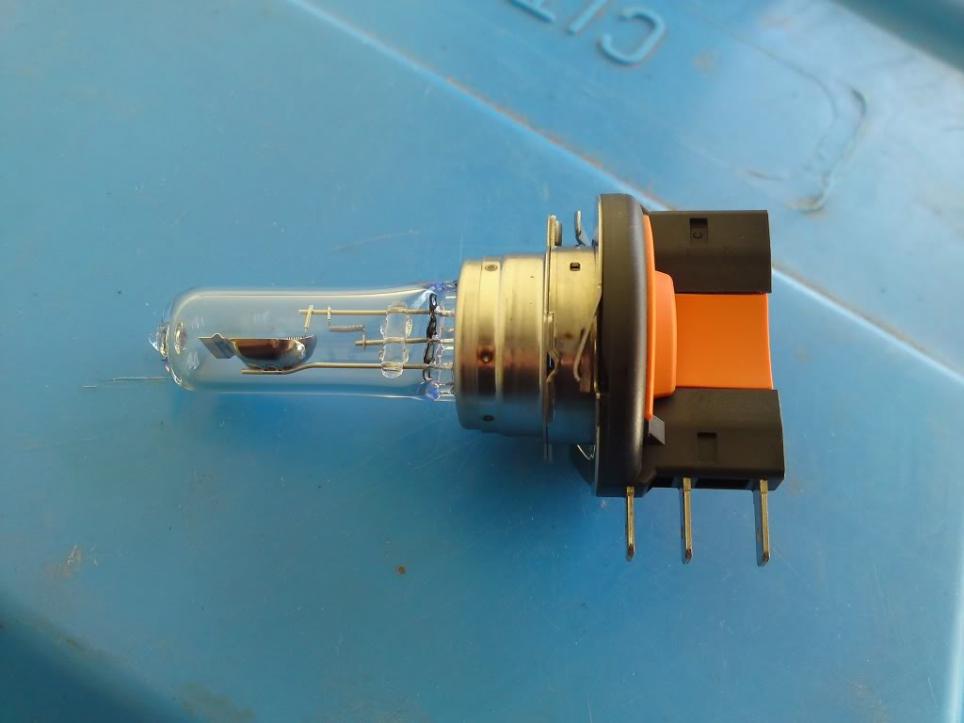

          Any tinting or slip-on will only diminish the light output.
          Reason H15 is hard to find is that it looks like this and only Osram makes it
          Tig 162 R-Line; Audi TT
