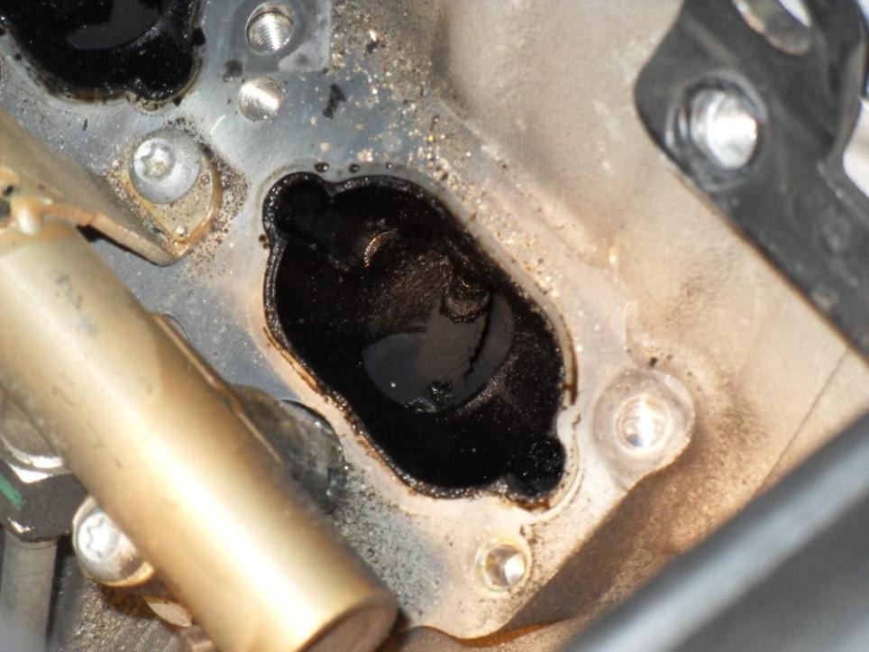

Your Vento isn't Direct Injection, so you are correct as the fuel is injected before the valve & the solvent properties would help keep it relatively clean.Originally posted by Bora Sport View PostI have no experience with DI engines however I can tell you that my local VW dealer has been trying to sell me this for the last 8 years and I personally think it is a blatant money grab. I pulled the head off my Vento at around 360,000k's
DI injects straight into the cylinder, therefore the inlet doesn't get any solvents & depending on driving style, PCV, etc you could get a fairly hefty build-up of carbon on the inlet.
Something like this:
Spot on. Explain to me how a spray is going to remove baked on carbon, let alone a mm or two of gunge PCV/egr oily sludge mix.
Will help, and better than nothing, but you eiother ignore it, physically clean it, or get a catch can of some sort. Even that doesn't totally stop it.....even your turbo is a total oil loss bearing....2014 Skoda Yeti TDI Outdoor 4x4 | Audi Q3 CFGC repower | Darkside tune and Race Cams | Darkside dump pDPF | Wagner Comp IC | Snow Water Meth | Bilstein B6 H&R springs | Rays Homura 2x7 18 x 8" 255 Potenza Sports | Golf R subframe | Superpro sways and bushings | 034 engine mounts | MK6 GTI brakes |
