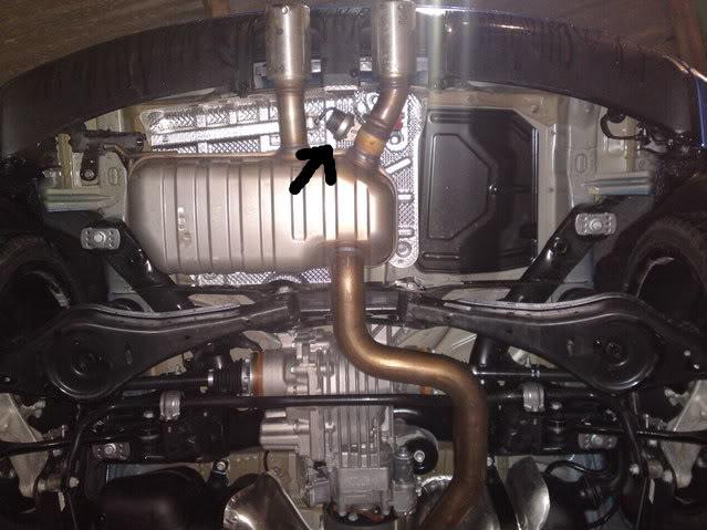

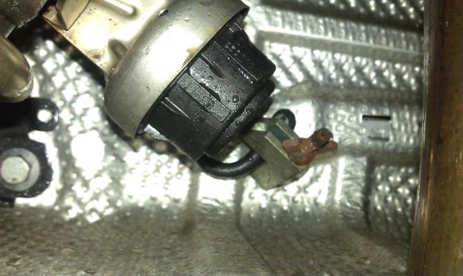

                        I was under the impression that the pipe you have to clamp is near the tailpipes as per the below pictures, not behind the rear passenger wheel.

                              Yes that is the correct tube/pipe. But if you follow it you will see it goes to behind the passenger rear wheel. So I chose to block it off there where it is less visible/obvious to the VW dealership or Police.
