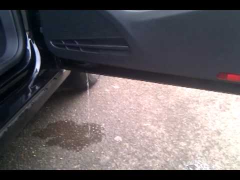

    I've had my GTI for just on a week now and I've noticed that when I open my car doors, either after washing or having it sit in the rain, that there seems to be a reasonable amount of water trapped by the bottom door seals.
    Depending on how much water has been on the car I can also hear it sloshing around in the doors then coming out of the drain holes in the bottom when the door is opened.
    It looks like part of the new noise reduction work that VW did was this extra weather sealing on the doors including the bottom.
    This wasn't on the previous MKV GTI that I had.
    I'm wondering if this seal is pushing onto the holes covering them up.
    Then when you open the door the hole in the bottom of the door is clear and the water come out.
    Happens on both front doors and a bit on the rears as well.
    Anyone else noticed this?

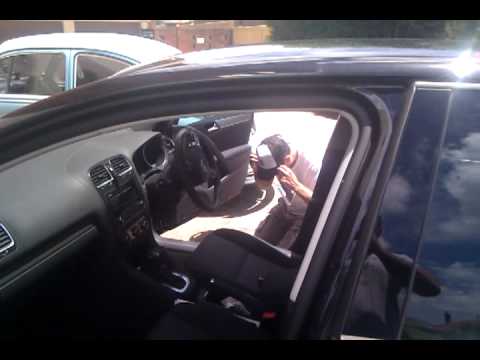

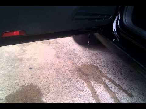

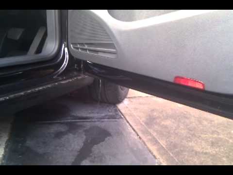

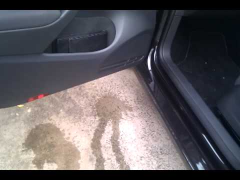

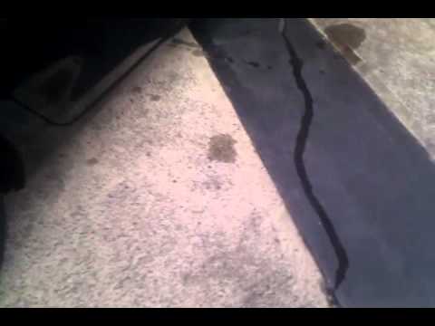

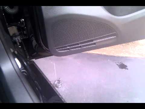

            Water held in Doors thread - Now with Video
            Hi Guys,
            I too am having this problem, I have got a collection of videos which I have uploaded to youtube.
            I have spoken to both Barloworld Volkswagen in Five Dock NSW (the dealer - 155 Parramatta Road Five Dock 2046, Australia - (02) 8745 3222) and Volkswagen Australia and they have said that this is not an issue and will not be doing anything about it. Basically they said tuff luck, it was designed like that.
            I call bull****, and I have lodged a complaint with The Department of Fair Trading who seem to agree that any reasonable person would not expect their brand new car to retain and leak water after rain.
            When I told VW that I had spoken to Fair Trading they asked what I hoped to achieve by doing that, my response was "If it is not an issue, it is a feature and it is a feature people should know about. If I would have known about this "feature" I wouldn't have purchased the car, so I want this feature to be listed with the other features is the brochure, website and other marketing material." The chick kinda laughed, but I told her I was dead serious.
            I can't sell this car with this issue as whoever I sell it to will want my head on a spike after it rains. If I disclose that it leaks water then obviously I won't get a decent price for it which is unfair.
            I have also told VW that if it isn't an issue, they can have the car back.
            The silence is eerie.

              I've yet to see a wind-up window that doesn't let water inside the door — for this reason doors normally have protection (usually a bit of cheap plastic film) to keep water off the interior trim, and one or two holes to let the water drain out over the sill.
              To this extent your dealer and VW are correct, but this draining should be continuous — not just when the door is opened.
              Just checked mine and it has two drain holes in each door — when the doors are shut these holes are between the lower rubber strip and the door seal, so if you have a tight seal on the lower strip (have you had the doors adjusted because of wind noise, or do the doors actually contact the sill?) then the water will accumulate in/under the door until either it seeps into the car or the door is opened.
              Incidentally, I've seen lower door panels eaten out by tinworm because the drain holes were either non-existent or blocked, so it's a good idea to check them now and then.
              If you don't get anywhere with VW, a fairly simple cure might be to glue a small strip of thin neoprene to the lower seal either side of each drain hole to make a channel for water to escape.
