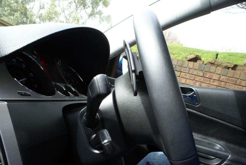

                Anyone done this on the R36, would be interested to know about clearance with the stalks?
                Gone...........R36 Icelandic Gray Wagon
                Specialising in off-topic discussion
                • #68
                  Apom, I received mine today too. I will get around to installing them in the coming days.
                  I thought about stalk clearance a little over the weekend when I was using them all a lot - wipers, indicating, and cruise control! I think they will be OK if the cruise control stalk is flicked to the "off" position... something I discovered on the weekend after over two years and many many uses of cruise control.
                  R36 =
                  • #69
                    I think it was mentioned earlier in the thread on the Golfs. I noticed the other day in the R that the factory RHS shifter is already very close to the stalk. While it didn't bother me, seems like it was poorly placed given how much room they had to work with?

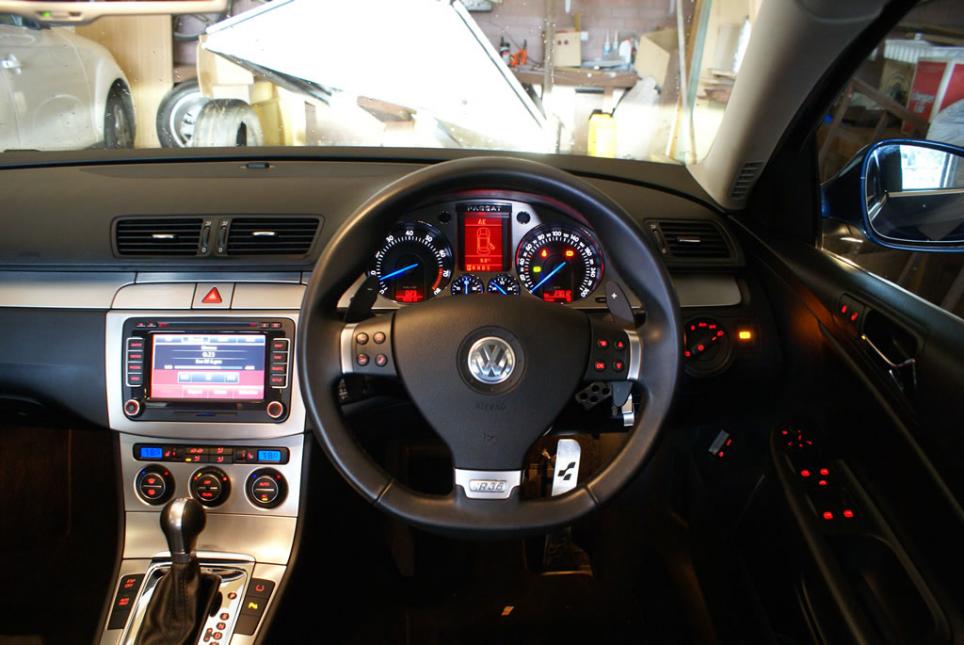

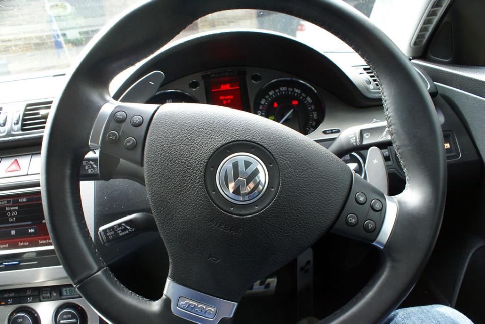

                          I did this to my R36 today. Some notes...
                          1) Put the key in the ignition and ensure the steering wheel is unlocked before disconnecting the battery.
                          2) The airbag fuse is on the left side of the car, not the right as stated in the manual.
                          3) I found the tabs holding the pin in place to be fairly easy to remove, when using a wide flat head screwdriver. My first attempt with a narrow head scrwedriver failed.
                          4) I didn't need T40, only T20.
                          5) Remember the battery is in the boot
                          6) Do it.
                          R36 =
