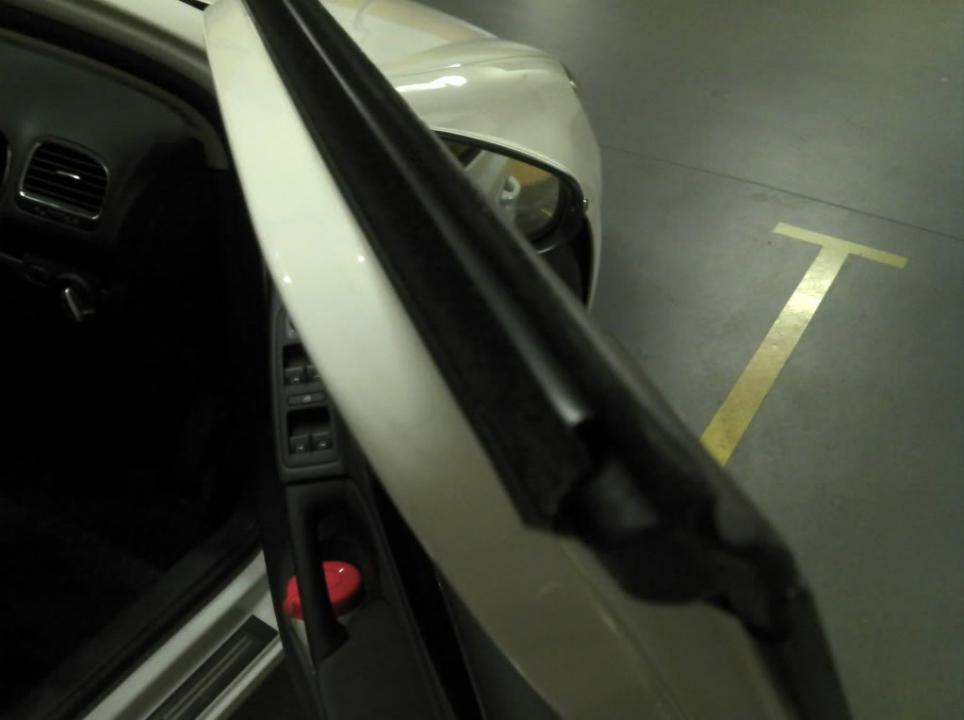

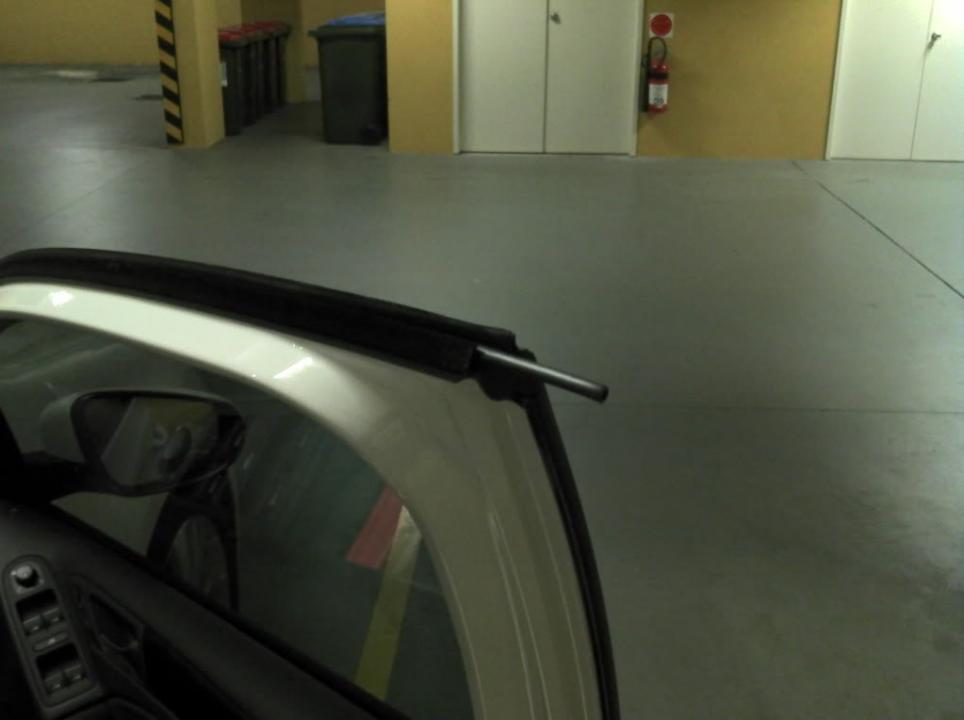

It's a worry that so many of us are suffering these door felt/rubber squeaks but having looked at the 22 pages of this thread I am amazed people are still bothering with temporary solutions. A US forum details that the problem is the felts rubbing on the tops of each door against the body. It's got nothing to do with whether it's waxed or polished or soaped or clean. It's a bad design by VW. The felt is simply too thin. The solution in the US? Buy some flexible 4mm or 6mm irrigation tubing from Bunnings and insert it in the gap between the two bits of felt in your doors. Two months on it has worked perfectly for me. No more sticky rubbers, messy door sills with gummi pflege overruns and finally after two years, a quiet car. The guys on the US forums were engineers and said that the doors simply needed thicker seals and the felt was to blame. I didn't believe it as the felt is so soft but try this fix and you will be amazed.GTI, 5 dr DSG, Tornado Red
Thanks for the tip. Mind taking a photo for us?
Check out these photo's as requested, use the normal 4mm irrigation conduit which is firm plastic this performs best, front doors from about the mirror to the top edge and for the rear doors just the top edge will do the trick. You can buy 10m in most hardware shops under $4.00, you will only need about 3.5m.Originally posted by Ryan_R View PostThanks for the tip. Mind taking a photo for us?
Just insert the conduit as shown cut off excess, there is no need to fix the conduit, it will stay in place contained by the door seal.
Good luck it's always been a quiet car that's the reason for the irritation any abnormal sound is noticeable but this raises the bar a notch further for those with squeaking door rubbers, I suspect this was a problem with earlier model MKVI's. I've been in a recent model with 10K on the clock and didn't notice the squeaking so maybe there has been a modification to the felt/rubber.Last edited by rosslm; 20-07-2012, 07:38 PM.2017 MY18 Golf R Wolfsburg | Oryx White | DSG / 2021 MY21 T-Cross Style | S+V Package | Limestone Grey
Is it always that noticeable or is the reveal in the 2nd photo just for the camera? Sure it would raise a few eyebrows from passengers or if you ever sold it.
It's hardly noticeable, it just looks like part of the seal. It's unlikely anyone would notice it as non standard.Originally posted by Ryan_R View PostIs it always that noticeable or is the reveal in the 2nd photo just for the camera? Sure it would raise a few eyebrows from passengers or if you ever sold it.
The close up shot is just that to show the conduit in place.2017 MY18 Golf R Wolfsburg | Oryx White | DSG / 2021 MY21 T-Cross Style | S+V Package | Limestone Grey
