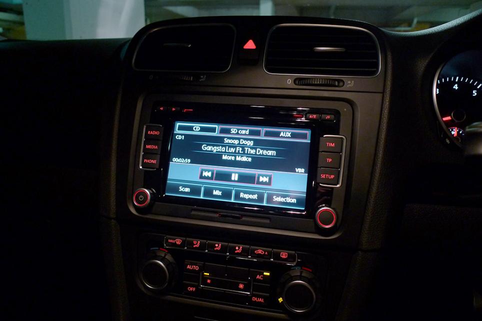

I managed to get a second hand RCD510 to replace my bog standard RDC300 in my MK6 2.0 TDI.
Her's the how to" if anyone else is going to do the upgrade and save about $170 in "dealer labour".

To install the new unit, reverse the steps (i.e. hold in one hand, insert the big wire block, snap the lock down, insert the antenna loom, push the tab in, slide the box into the cavity, replace and tension the screws (gently) and position the fascia panel and using thumb pressure, pop all of the tabs back in.
It make make some CD hunting noises as power hits it but that's OK.
When prompted, enter the security code and you are on your way.
All up it takes about 10 minutes.
If anyone needs pics or advice, just IM me.
