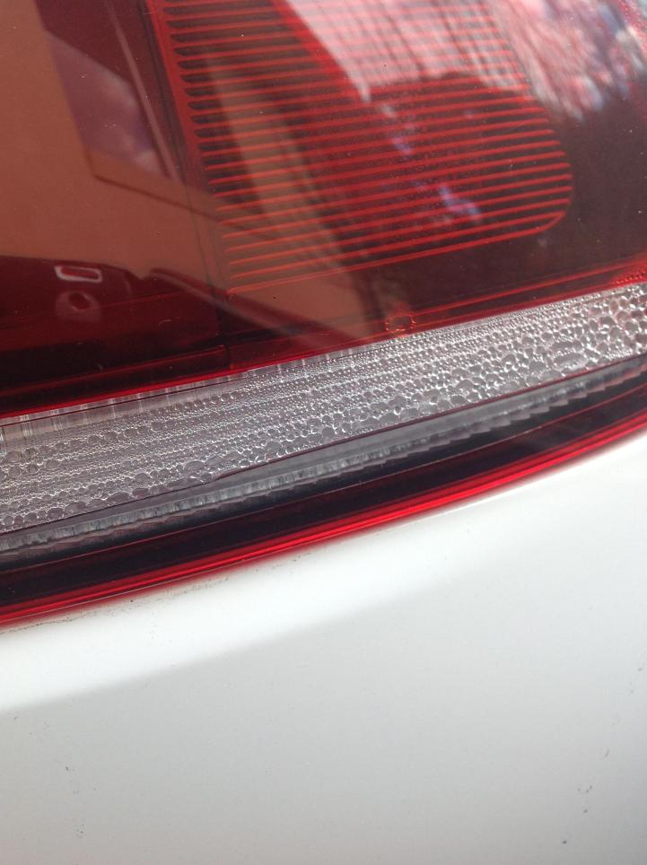

      • Leaking Tail Light.
        Can't see any gap, but water is in there. Should I drill a tiny hole on the inside (black part) of the lens assembly? It would not affect the lens itself, but not sure if it will cause more issues than it solves....

          You went with aftermarket (non OEM) tails, didn't you? Hate to say it, but this sort of thing is much more likely to happen with the eBay aftermarket stuff.
          If you drill a hole, you'll just allow more moisture to get in and cloud up the lights on an ongoing basis. They really should be completely airtight. Your best bet is to let the lights sit in the sun (or apply gentle heat) and the moisture will hopefully evaporate. No guarantee this won't happen again of course.

              The same thing happened to my tails after using a pressure sprayer a bit too enthusiastically to clean the car- and they are original parts. I took the lights off, poured out what I could and then used a hair-drier to completely dry them out. took about 15 min. Couldn't find any cracks or gaps and have been fine since...

                Thanks good to know. If the replacement set does the same thing - Ill try your solution. I also bought some flexible clear sealer from Bunnings, so might apply that around the assembly before installing . . .
