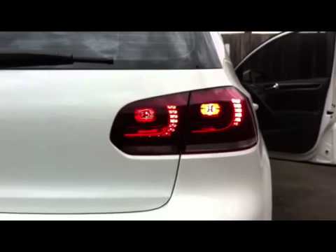

      • Originally posted by backdoc View Post
        Please advise if this has been previously discussed, but are the R tails always on?
        I noticed when reversing today in perfect sunshine that the tails were on (like the headlights were on) and only went off when I turned the vehicle off.
        If this is not normal, does the recoding change this?
        This is not normal. I vaguely recall someone else experiencing this problem, and a physical check/recheck of the connections fixed it. Go through and unplug all your connectors and adapters, and reattach them, and see if that fixes it.

            Interesting discovery, after checking all the connections (which were all good) - with the DRLs set to on in the lights section of the menu, led tail light cluster is on. Turn off the DRLs and the tail lights instantly turn off also.
            I guess this is a feature. DRLs front and rear?

                          Not sure if this is going to help, my GTI came fitted with DRL's and R tails from the dealer (Adidas version came like this) these are not aftermarket. The DRLs when turned on in the MFD and the light switch set to 'A' the tails are NOT on. If you switch to 'parkers' (one after 'A') the DRL's dim and the tails turn on.

                          • FWIW, R tails are not on when DRL,s are activated, probably not much help, but just a follow up anyway. Hope you get it sorted
