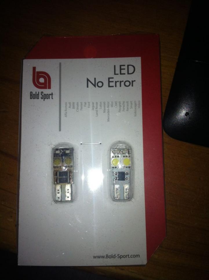

        Well I worked out what the acrid burning smell was.
        it was from the footwell Lights.
        I replaced the standard globe with an LED from Boldsport 2 weeks ago. Only the 1 as I wanted to see how hard it was, and I was waiting for some red-ones to arrive from Ebay.
        There was a nasty acrid burny smell in the car for a few days, but it died down a little - couldn't work out where.

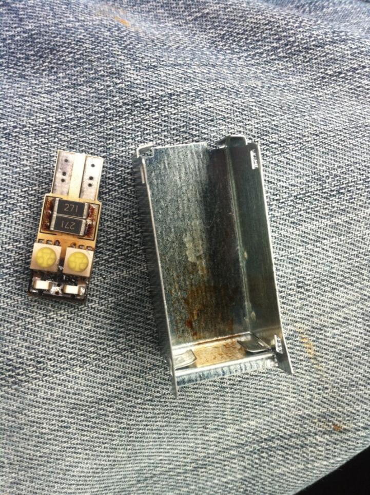

        Red ebay ones arrived, so went to put them in and found this:
        (the brown is vertically UP from the light - i.e its residue from burning / gas)
        2 weeks,..
        Perhaps summer and LEDS (and decently priced ones too!) - aren't the best idea.
        ---------- Post added at 02:36 PM ---------- Previous post was at 02:32 PM ----------
        p.s It was STILL WORKING when I took it out.
