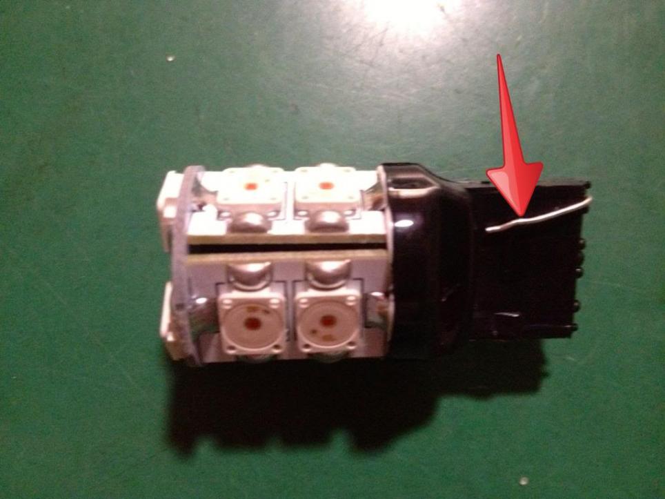

  • Thanks for the reply guys. I might go try the other side and try both leds in that one. I have put the bulb back in and it worked fine. I can't remember now whether I tried both leds in the same socket. If they don't light up, I will email them and see about replacement.
    Thanks again guys for the help. Unfortunately, Lucas, my son has moved from Newcastle to Sydney, so I won't be heading to Newcastle anytime soon. Appreciate the offer of trying them in my car though. Heading out to try the other side. Damn pain getting the grey covering off the inside of the boot too. Back shortly, I hope.
    MkVI GTD fitted with Bluetooth & MDI, CSG, DSG, Xenons, RNS510 with Dynaudio, ACC, Weathershields, Mudflaps, Sunroof, LED Tails, LED Indicators, LED Foglights, Interior LEDs, Tinted, RVC and Towbar - Gosford.
    • Success. The problem was a simple fix. I moved the wire away from the edge so it would make contact with the metal piece in the socket. How easy was that. I feel a bit silly not even thinking of that earlier.
      See pic. Originally the wire was parallel to the edge of the black section. Thanks again for your replies, inspired me to try again.
