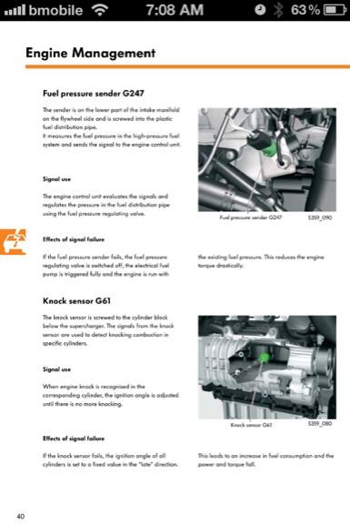

                              Well the car is under warranty and I am not sure if the dealer has a way of knowing he used super unless the knock sensor readings are stored in memory.
                              Anyways he definitely did not keep revs to a minimum and I am sure he put the engine under high or max loads daily to and from work.
                              Here is the bit about the knock sensor for the 1.4 tsi engine
                              I'm surprised by the number of sensors and fail safes this thing has. Then again I am no car buff.
                              To the poster before Diesel_vert our country only has Ron 95 for our highest spec fuel and theses engines are built to suit. They aren't built for Ron 92 though. I guess he figured once the car "felt" ok with Ron 92 then he was in the clear...guess not!
                              • The problem with rely on the knock sensors to allow running on lower octane fuel (than what the engine was designed for) is that the ECU will keep trying to run at its normal timing (and boost for a super/turbo charged engine) and will detune itself as a RESPONSE to knocking - it doesn't just stay detuned as it will keep testing to see if it can run as it is supposed to. This means that the engine will knock at a reduced rate just as you have surmised and damage will only be slowed, not prevented.
                                What your friend needs is a remap that runs with retarded ignition and lowered boost.
