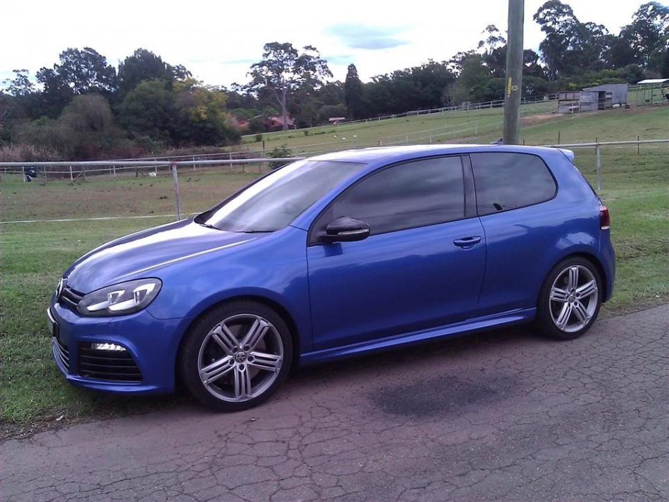

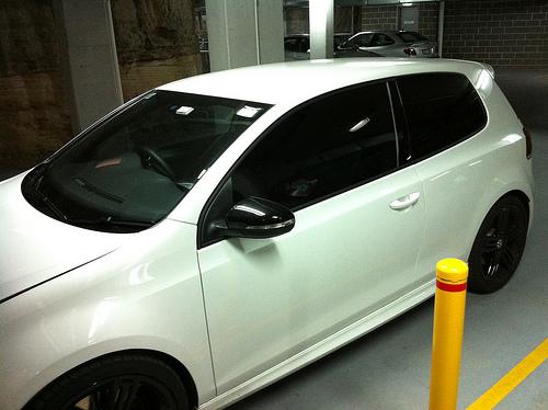

      Pics of my car: (pics were taken early this morning on a semi cloudy day)
      • Hey Lucas_R. Thanks for the pics. It's always very hard to tell tints from pictures, but being that there seems to be such a close match on them, I'm guessing Solargard HP Supreme 22 on the front and HP Quantum 52 on the back?
        • Robert suggested 16% on the fronts and then used 35% over the top of the privacy glass area. So that's what I went with.
          The other option was, as you mentioned, 22% on the fronts with 52% on the rears.

            • Im not sure Corey. I was paying attention but not that much attention as to note which styles of tint he was using. But as im sure you know, he has it down pat and knows what he is doing.
              In hind sight, i probably should have picked the lighter 22% (fronts) and 52% (rears) combo, as the 16% and 35% is quite dark from the outside looking in. I was umming and arring on the day but he convinced me to go with the darker one.

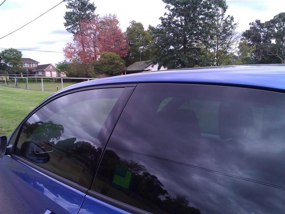

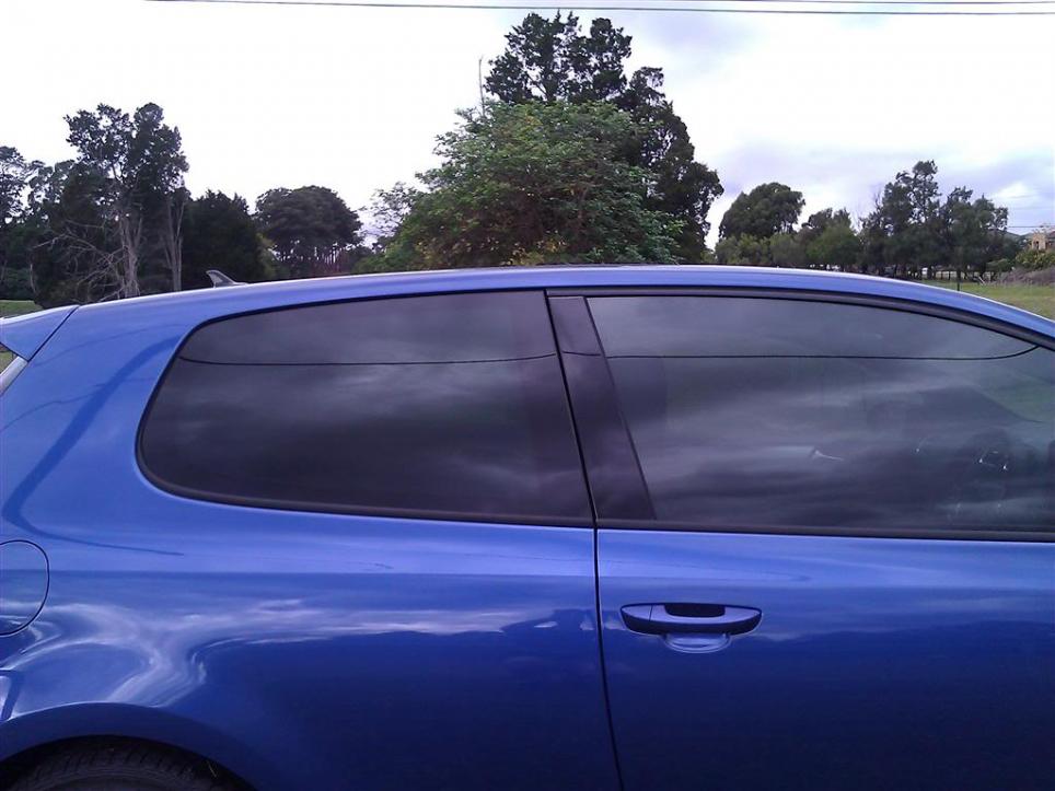

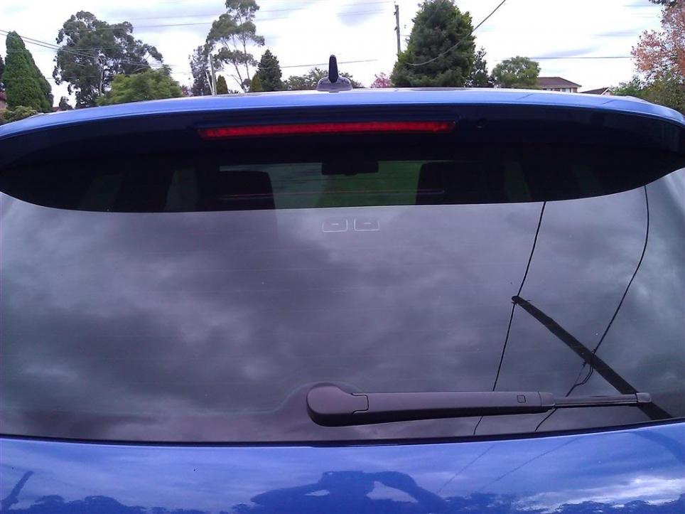

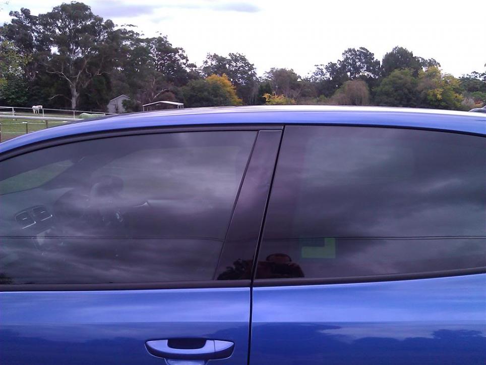

                  • Ok, so I've taken some photos of my car's tint.
                    I cannot stress enough how much I hate taking photos of tint as it's almost useless to give an actual indication of what it's like in real life, but since you asked for it, here you go. The day is overcast, the car hasn't been washed for 3 weeks.
                    The tint was installed by Rob at Hunter's Hill Tinting on Christmas eve (from memory).
                    The tint used is Solargard HP Supreme 35 on the front passenger and drivers window, as well as Solargard HP Quantum 52 on the rear side and rear windows.
                    The HP Supreme 35 was used on the front windows as it was developed to compliment European "greenish car glass" well and as it is 35% LVT it is 100% legal in most states in Australia, except at least South Australia where they have a minimum of 70% VLT for the front row of windows.
                    The Volkswagen "factory/dark/privacy tint" has been measured to be around 42% VLT so on those windows we used a HP Quantum 52 which is 52% VLT rated film to bring the VLT down to about 21% VLT (.42 x .52 = .2184). Whilst that isn't legal for passenger vehicles, if it were a commercial vehicle there is no requirement to have any rear side or rear windows at all, so I don't believe them to be important, and I don't believe the police would have issue with any respectable driver and the rear windows anyway.
                    The reason Rob suggested using HP Quantum 52 for the rears instead of sticking with the Supreme was that the Quantum is slightly more "silverish" and therefore balances out the colour tonality between the front and rear windows better. If I were going really dark on the car like Lucas_R did (16 VLT front, plus 35 VLT rear for an effective ~15VLT, then this might not be as important - but I would 100% trust Rob's advice there.
                    Another option for those who want darker front windows than I is to have the HP Supreme 22 on the front row. Whilst that's not legal in Australia, it would match both colour tonality and % VLT with the HP Quantum 52/Privacy glass combination.
                    So as I said, the front windows are completely legal as they're a 35% VLT film. Yet they are not so much lighter than the rear windows ~22% VLT that they look out of place - at least in my opinion.
                    On the above picture you can just see a small wedge of grass and fence through the left rear and then front window, to compare the ~22% VLT to the left front's 35% VLT.
                    Car is too shiney...
                    From the other side to just get some difference in light...

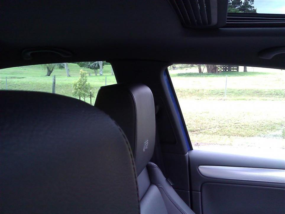

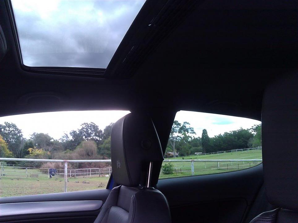

                    From the inside. Please note that it is not glarey in the car, it's just the camera is now trying to compensate. You can see the difference between the 22% VLT of the rears and 35% VLT of the fronts.
                    And finally from the other side. On this one I was actually standing outside the front passenger door, with the door shut but window down. I've used an angle to get the sunroof in. I have NOT added any tint to the sunroof - so that's the standard VLT level that VW ships their sunroofs with. Just in case anyone wants to use that as any reference point.
                    But again, remember when looking at those photos, particularly the last two, that the driver's and front passengers window there are 35% VLT and is the darkest legal in Australia. The rear is 22% and is darker than legal. I've no idea what the sunroof VLT is because I don't know anyone who's measured it.
                    As I said, I really don't think that the average camera, the average monitor, and the average photographer, can do anything useful to accurately represent what the tint looks like in real life - and I can assure you, these photos are no different - but I guess it's at least another reference point.
