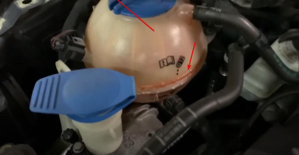

    My sister in law asked me to help her replace the coolant expansion tank that is leaking. It looks like this, it seems to be a common issue on those expansion tanks where the coolant evaporates through the joint.

    So, after having the lid off to remove the pressure, put it back on.
    On your last step, turn the tank over and with your finger, block the upper hose connection; take the whole tank out upside down. Then put your old coolant in a bottle.
    I would suggest topping it up with fresh G12, as the coolant in the tank gets a lot of debris.
    Then drop off the old coolant and anywhere that recycles it, think supercheap and other places take it now.

      Thanks MIG for the reply.
      Ok seems like blocking the hose with your finger is the way to go.
      Thanks for confirming and good advice re disposing old coolant that was in the the tank. I'll fill up with fresh G12 when I put everything back together.
      Thanks for the help, appreciated
        Job done, it was pretty easy and I didn't make a mess. I thought coolant would be gushing out of the hose as soon your disconnect it from the tank but not really.
