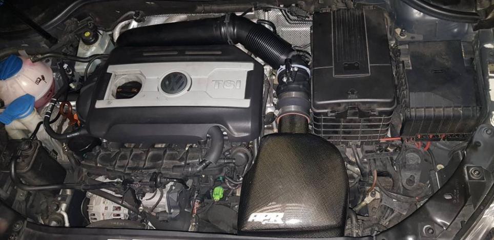

    Probably drawing in air after the MAF. If you have the stock intake. Refit it as a test.
      Unfortunately I do not have the factory intake :/

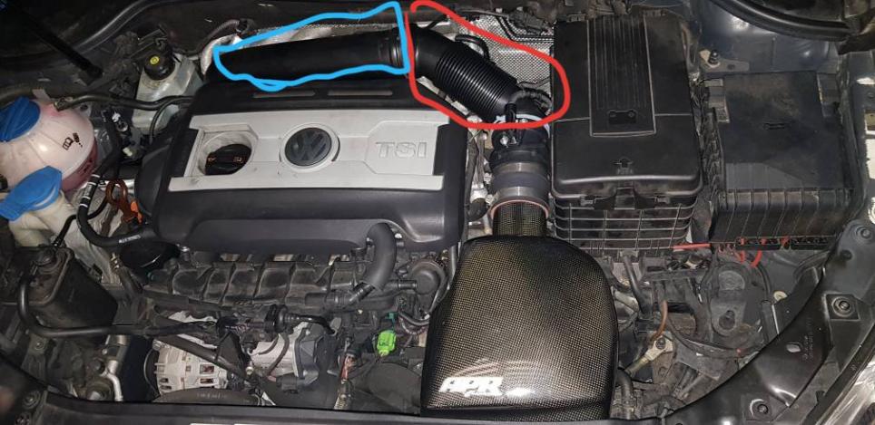

      The pipe circled in red is what was replaced at the same time as the MAF I believe. Orignally they thought it may have had a slight crack and was leaking, but when it was pulled off they didnt see any cracks, replaced under warranty anyway because well why not.
      I could find the part number possibly if I found the paperwork which is currently buried.
      The pipe circled in blue - I'm thinking that wasnt replaced. (Sorry for the dodgey circles, my S pen and screen protector dont get along)
      The spring clamps still seem quite tight. Taking these photos earlier I'm thinking I should invest in some quality hose clamps aswell though.
      But unfortunately I have no way to fit the stock intake and test it.
      Sent from my SM-N950F using Tapatalk
        It would be easy to visually check those 2 pipes. Although without vcds to take some logs you'll not get too far.
        Measuring block 032 shows fuel trims. A definitive indicator of air leaks.

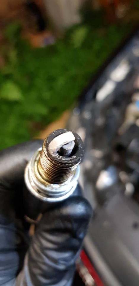

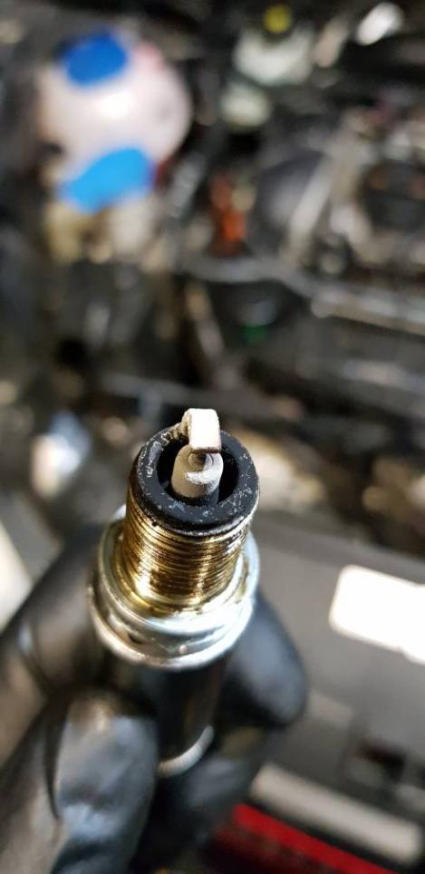

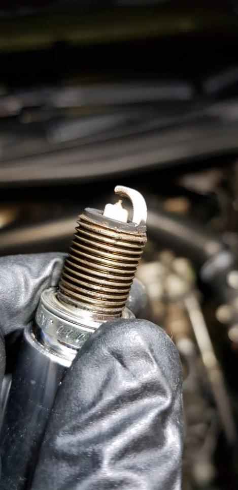

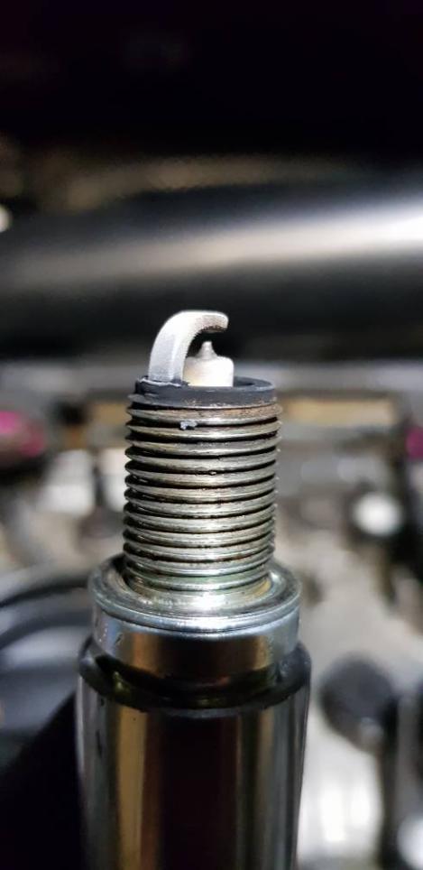

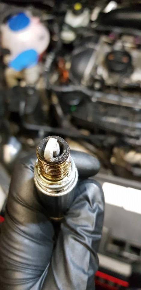

          I pulled the spark plugs out today
          Vw seems to reccomend gaps of 0.8mm and the local guy that does APR tunes said they generally use gaps of 0.55mm with the tune that I most likely have.
          I could only fit the 0.75mm feeler guage in, but I'm thinking they are OEM replacement plugs with alot of build up.
          I'll post some photos and let you all have a glance.
          I'll be getting new plugs early in the week.
          Then go from there
          The first three plugs (pictures) are from cylinders 1,2,3 (that's from the cam gear side of the motor in order - not actual piston order) I tried finding the actual numbers for the pistons but I could not. I'm guessing from memory it will go 1,3,2,4 from cam gear onwards, but I could be wrong.
          The last 3 photos are all from piston 4 ( the one closest to the passenger side of the vehicle)
          I have 150psi compression on all cylinders.

                      On the Mk6 GTI, the hard black plastic pipe that runs along the back of the engine bay (the straight piece you have highlighted in blue in your image above) has a connection underneath it for a PCV pipe. I know on a lot of the aftermarket pipes this is known to leak which could cause the symptoms you are having. It might be worth checking this connection is not leaking on your car (or even put some silicone sealant around the connection).

                        I've managed to narrow down my spark plug options, I'm planning to get some NGK iridium's with the standard 0.8mm gap (the APR guy says they usually gap them at 0.55mm but that's usually for cars running stage 2 with 25psi+ boost. Which I'm pretty sure I'm not running. A friend with a mk6 golf is getting new gauges in the next couple of weeks so I plan to borrow his old one to see just how much boost I am running. But standard gapped plugs should do me and the car a world of good.
                        As for that pipe circled in blue. I'm fairly certain that it is the original OEM one from factory. I could be wrong how ever I shall try to investigate that when I change my plugs over this week/weekend. I am also thinking my PCV may be on it's way out.

                              On that thought - in the photos on the previous page: what's going on with the rubber hose connected to your intake manifold (the one that runs under the engine cover)? If that hose doesn't have a good seal, it's going to throw all your boost readings off, and could make it run really rough (ask me how I know...)
