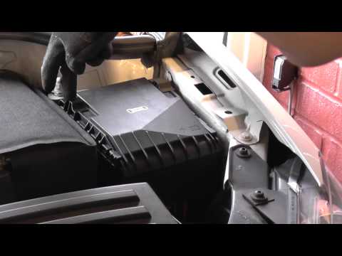

      If it is standard, then i would check over all of your connections in the fuse box in the engine bay (just near the battery - see video below) as all the connections are bolted to a terminal (easy to check and tighten if necessary - also easy to see if something has been fitted aftermarket). Make sure none of the wiring here is obviously damaged/burnt/rubbed through and possibly causing your issue.
