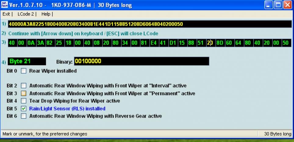

I've checked out the coding and testing parts of this guide:
rain light sensor retrofit and installation- VW DIY | VW TDI forum, Audi, Porsche, and Chevy Cruze diesel forum

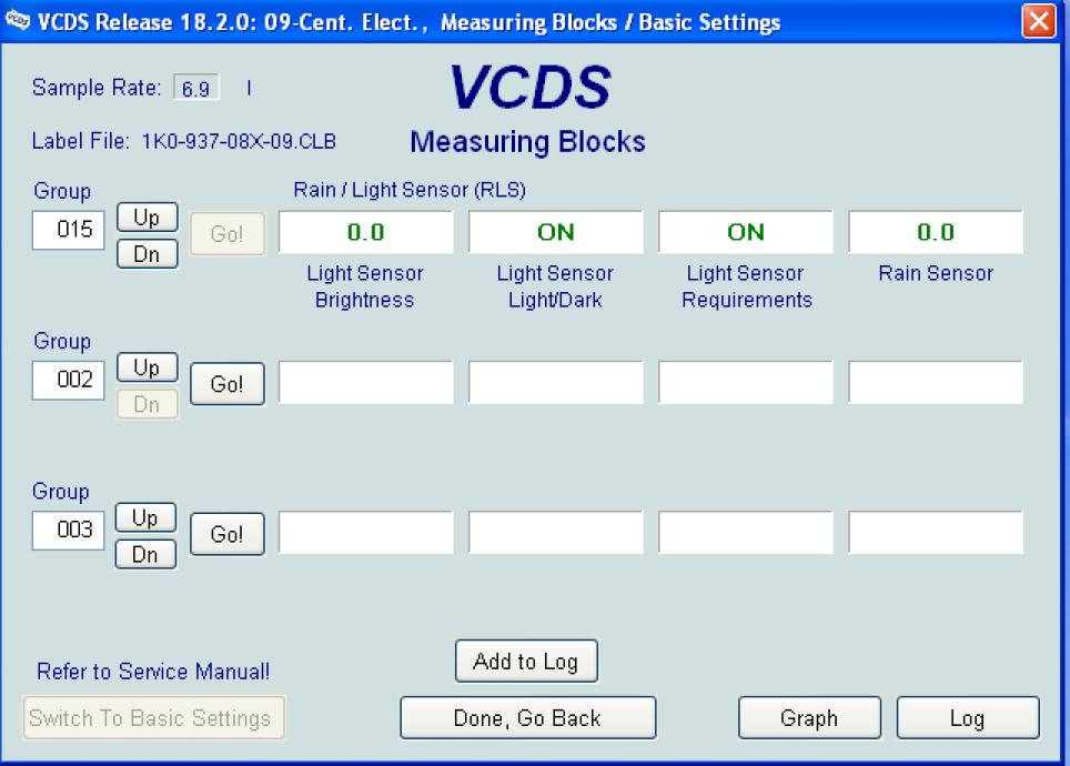

My module is (and was installed): I've also tested the rain sensor and it works flawlessly.
But the light sensor data never changes regardless of if I turn it on/off (and the green light does change), cover the front sensor or shine light into the rearward facing sensor:
Does anyone have any ideas on why this wouldn't be working?
