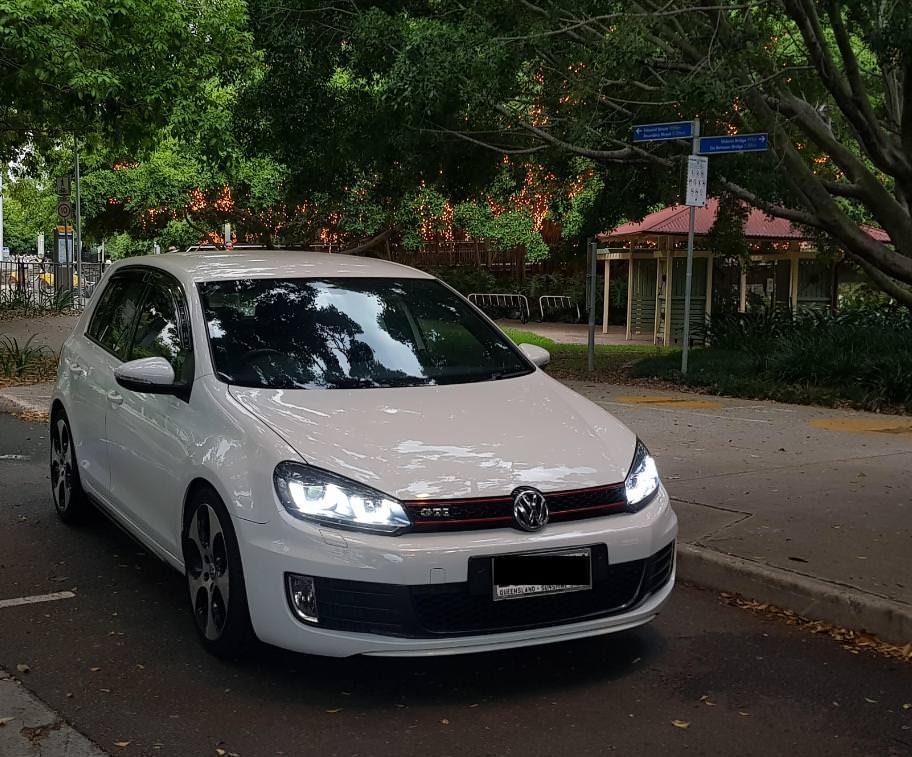

    Hi guys,
    I recently purchased and installed new LED headlights for my car and now have the bulb out error on the dash. Was just wondering if there is a way to disable the DRL's as that's what causes the error. I don't have the MFD option like most people, and the indicator / high beam trick (unless I'm doing it wrong) doesn't work either. I was told that disabling the DRL function would remove the bulb error, but all the normal ways don't work.
    Would removing my euroswitch and covering the DRL pin work, or should I just find someone in Brisbane that can help me code out the error?
    Thanks all
    Picture for reference

      According to the guy I bought them off, disabling the DRL's via the MFD / indicator method would remove the bulb error but the lights would actually stay on.
      I'll just find someone that can code the error out for me if possible. Otherwise it's not too big of a deal, the orange error is quite distracting though.
        Wasn’t it indicator stalk up and forward then turn ignition switch on and wait for the bing to disable dlrs on the mk6, (worked on my old 2009)
