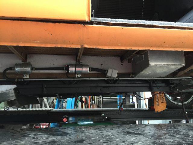

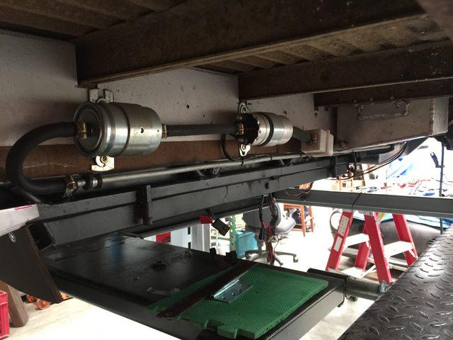

                  After more research I found there is no return line required for the fuel injection to the fuel tank as the pressure regulation
                  is performed by a regulator in an in-line fuel filter.
                  I'll now search for one of those and plumb it into my fuel supply line.
                  One of the VW filters I saw had (2) inlets and (1) outlet..
                  Wondering if (1) of the inlets could be used to feed back to tank..?
                  Cheers Tony

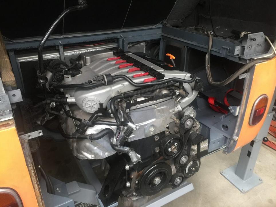

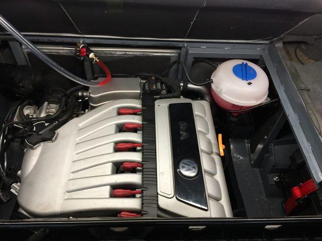

                    Well... Another month has passed and more progress made ..
                    Radiator coolant lines redone , connected and system refilled with coolant.
                    Fuel lines redone and incorporated a new pressure regulated fuel filter.

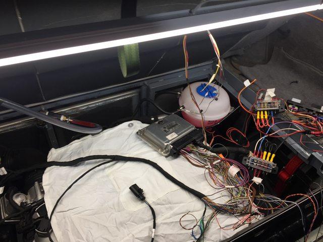

                        Heres where I'm at currently...
                        Cheers Tony
