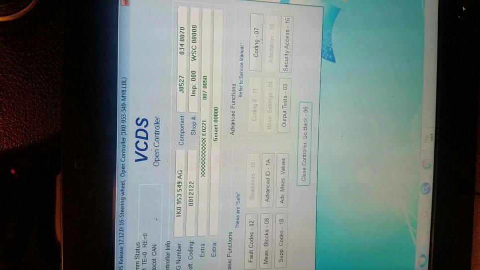

              What is the part number of your steering wheel controller? Address 19 from memory
                      Hi. Photo attached

                          Originally posted by AUC-05L View Post
                          Hi. Photo attached
                          Check the long coding helper for the module. I don't have the same module so I can't be sure that this is correct from the label file:
                          Steering Wheel Electronics (J527) Coding
                          0?xxxxx: Vehicle Type
                          0 = Normal / 1 = Special Purpose (e.g Taxi)
                          0x?xxxx: Transmission
                          0 = Manual Transmission
                          1 = Automatic Transmission
                          0xx?xxx: Steering Wheel
                          0 = Steering Wheel without Multifunction
                          1 = 3-Spoke Steering Wheel without Multifunction
                          2 = 3/4-Spoke Steering Wheel with Multifunction without Cruise & Voice Control
                          3 = 3/4-Spoke Steering Wheel with Multifunction with Cruise & Voice Control
                          0xxx?xx: Additional Equipment
                          +1 = Tiptronic (Shift Paddels)
                          0xxxx?x: Board Computer / Cruise Control System (CCS)
                          0 = w/o Board Computer and w/o Cruise Control System (CCS)
                          1 = with Board Computer and w/o Cruise Control System (CCS)
                          2 = w/o Board Computer and with Cruise Control System (CCS)
                          4 = with Board Computer and with Cruise Control System (CCS)
                          0xxxxx?: Rear Wiper
                          1 = Rear Wiper not installed
                          2 = Rear Wiper installed
                          If this is the correct label file then you have 0xx?xxx set to 2=3/4 spoke steering wheel with multifunction without cruise and voice control. Try changing this to 3 and test it ie your new coding will be 0013122.
                            I have the same part number for steering wheel
                            Coding is 0012021
                            Car is DSG Jetta - no rear wiper.
                              Coding is 0012021
                              Does your jetta have the dsg paddles? Think thats the only difference in the code. And rear wiper.
