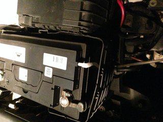

    Hi guys,
    Got a new heavy duty battery, according to Century website (where you input your car make and model), it recommended the DIN75LMF. So I ordered one.
    When I removed my old battery, which was a LION one, the Century battery looked a fair bit bigger/longer, nonetheless it still 'fit' in the space, however the standard VW plastic housing for the battery doesn't fit around the Century battery, and therefore the top plastic cover will also not fit.
    Anyone else had this issue? Have I bought the wrong battery? Should I just remove all the plastic trimmings?
    The battery seems to work fine.
    Cheers.

      You might find that your original battery was 242mm x 175mm x 190mm.
      The new battery sounds like a Varta E44; 278mm x 175mm x 190mm.
      You can pick up a new battery case (soft) with cover; VW Part No. 1K0915411B to suit the larger size battery.
      I have the above brand new in plastic wrap, PM me if interested.

          To be clear, the battery 'fits' in the battery space ... but the plastic housing doesn't fit quite right, and therefore the lid also does not fit.
