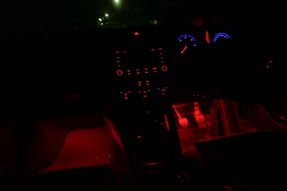

Red ambient footwell lighting configured to come on when the dash lights come on (with the headlights or parkers):

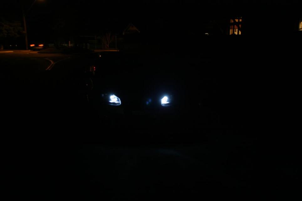

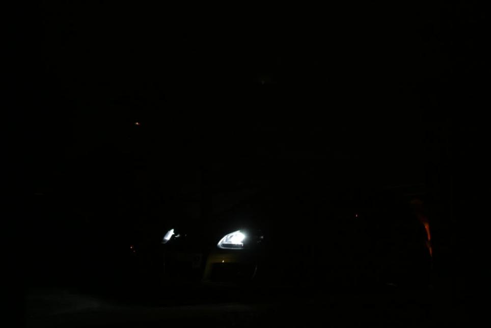

SMD parking lights (similar to LED). they're supposed to be white but they look slightly blue... but they're bloody bright for parkers!

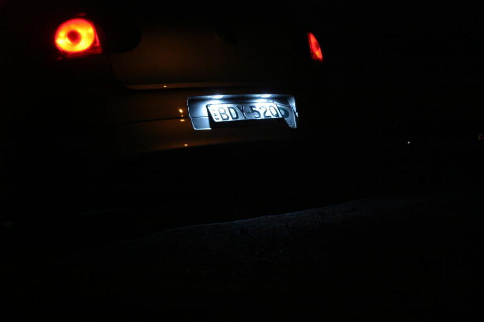

LED number plate lights:

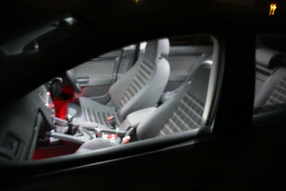

LED interior lights, they're not quite as bright as they appear in this picture but it gives a good idea of their white light instead of the yucky yellow:

oh and for the parkers and number plate lights you need to use a load equalizing resistor put in parallel, otherwise the car will think there globe is blown and cut the power to that circuit (since LED's dont create heat and therefore have no resistance). or you can be super lazy like me and just use the regular globes as the resistors and splice them into the wires
