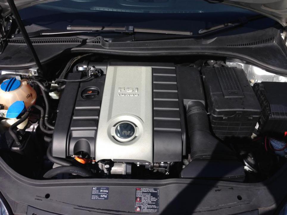

I picked up a 06 Jetta 2.0FSI Turbo about six weeks ago, it has 131,000km on the clock. It has the optional leather seats and the optional headlights.
Through my experience, I find the car to be quiet troublesome/high maintenance
Pros so far
1-POWERRR. it's really powerful and that low end torque is amazing, very beneficial in city driving
2-The car is "well-kitted", very high level of equipment for the price you pay for one of these
3-Looks, I find them orite looking
4-Very comfortable on long trips
5-Great fuel economy in comparison to other turbo 4 cyl cars (e.g. Subaru Impreza WRX)
Cons
1-PCV failure multiple times without a long term solution from Audi/VW
2-Diverter Valve failure (revision D failed on me)
3-Cam follower failure, replaced mine yesterday
4-Oil consumption (what the hell were VAG engineers thinking when they designed this engine lol) Mine is sitting on around 300ml of oil per 1,000km (I tested it).. I add a bit of oil once a week, it didn't feel right to me at the start since I am used to only lift the car bonnet up once every 10,000km when service is due, I actually have heaps of spider webs under the bonnet of the Honda Civic coz I never ever open it haha
5-I heard that there's a seal inside the HPFP that goes off with age and allows the petrol to escape into the crankcase thinning out the engine oil and increasing its burning. HPFP rebuild by APR or a similar company would be required
6-Dashboard would look much better if the air vents and buttons had chrome surrounds... etc. The black on black theme gives me the impression like the car is from the nineties not 2006 model
7-DSG hesitation, and my car also has DSG background noise. When it's idling in "D" or "R" there's a low diesel engine-like background noise sort of like krk-krk-krk-krk-krk (was told it could be DMF going bad, quoted around $1,700 for the job), as soon as I snap it into "N" noise disappears
8-Chassis is way too soft for my liking, when I climb ramps e.g. at petrol stations the car makes all this creaking noises and I could feel the chassis twisting!! WTH
My 05 Honda Civic on the same ramp won't even produce a single creak or squeak and it would easily lift one of the rear tyres off the ground even when it's fully loaded with 5 people and luggage.. quiet strange the VW has a softer chassis and it's supposed to be the more sport oriented sedan

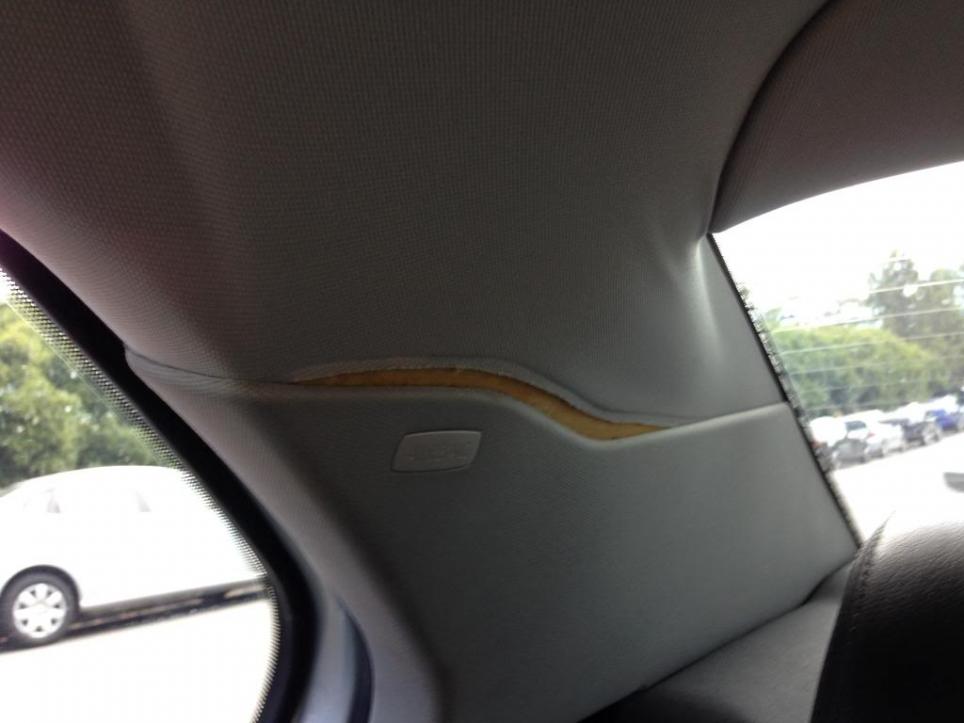

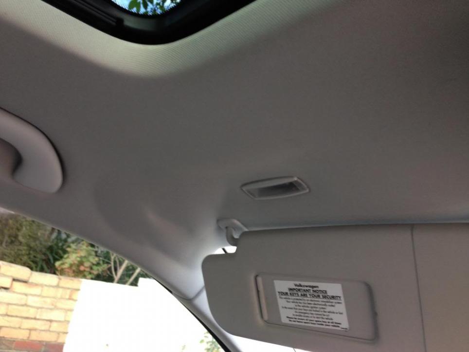

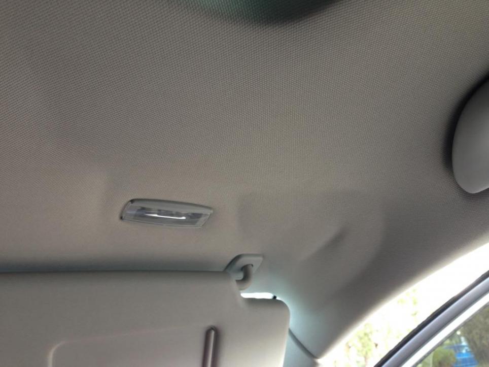

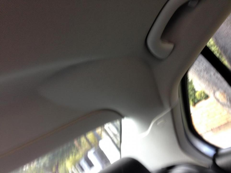

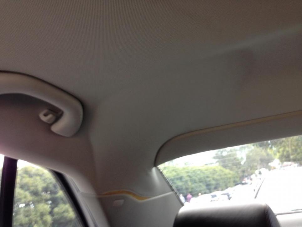

9-Build quality issues and rattling over bumps and on train crossings! The roof lining is falling apart, it looks like it's shrinking and it's getting pulled off the pillars! What happened to the German cars build quality?! lol
Since I bought the car so far I've replaced; the diverter valve, PCV valve, engine oil, oil filter, air filter and chucked in a set of Denso Iridium Tough Power spark plugs in there
I used Liqui-moly 5W-40 instead of the 5W-30 that was in it initially, I found the 5W-40 to burn less than the 5W-30. But it still burns
The 5W-30 is way too thin for a turbo engine in my opinion.
Before replacing the diverter valve, there was an oil leaking from in-between the diverter valve and the turbo housing itself, I found that after I moved to 5W-40 Liqui-Moly that oil leak was reduced and when I replaced the diverter valve, I made sure I tighten the bolts hard to eliminate any possible leaks but there's still a small oil leak there. The question is: why would there be oil at that location anyway? as far as I know the diverter valve only deals with air not oil. Why's there oil escaping the intake and ending up inside the turbo when air should be the only thing present there? tsk tsk
When I was replacing the spark plugs, after removing them, I got a torch and looked straight through the spark plug hole which leads to the inside of the cylinder, and cylinders number 2 and 3 were wet (may be cylinder 4 too, I can't remember), i.e. they looked like a fluid is lying inside the cylinder on the wall/piston. I couldn't tell if it was petrol or engine oil though. Two of my spark plugs had little oil on them when I pulled them out as well
All in all, this car seems to be mechanically a mess in comparison to my 2005 Honda Civic that it's supposed to be replacing, the Honda is ridiculously reliable! 4.2L of engine oil in, 4.2L of oil out, doesn't burn a single mL. Absolutely no rattles and a much stiffer chassis compared to the VW (no creaking noises when climbing ramps at all).
By posting here, I am trying to give this car one last hope before I put it up for sale on car sales! I really like the car and I don't want to sell it and I am sure that no other car in that price category would give me that much level of equipment and comfort, and I love the DSG gearbox and the way it shifts.. I like the low end torque and the way the car pulls but I can't keep a car like this that would drain my pocket so badly.. I don't mind spending a lot of money on my cars for the purpose of modifying and bettering them i.e. sway bars, Bilstein/KONI yellow shockers, JDM light weight rims, sound system... etc. but spending a lot money to fix underlying issues with the car itself really bothers me..
Are there any long term solutions to any of the problems I mentioned above? Has anyone else experienced the same issues? How did you guys deal with it? Has anyone sold their VW or thinking of selling it coz they're fed up with reliability issues like me? What would you buy if you were in my shoes and you decided to sell the Jetta?
If I ended up selling the Jetta my options for a new car would be 2006+ Accord Euro Luxury 6 Speed manual, 2003+ Subaru Impreza WRX 5 Speed manual, Subaru Liberty 2.0L Turbo 5 Speed manual, Nissan 200SX 5 speed.. The only car on that list that can match the VW refinement is the Accord Euro Luxury, but generally speaking all the other cars mentioned are very good performers in straight line and cornering for that price tag
I apologize for the long post and thank you for your help and time

Roof lining failing!
