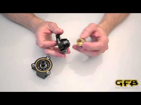

        Guy, what do you think of the GFB DV+? I have one of these on my car and it's works well. http://www.gfb.com.au/products/blow-...cations-by-gfb
        It utilises the stock electronic solenoid, but upgrades the piston, springs and base.

            I wonder if the cause of the check engine light on these cars was due to the original solenoid plunger and plunger spring that came with the first batch of these DV+'s, which were soon found to cause issues on the Golf R's with the valves leaking boost (apparently ok on GTI's with the turbo mounted DV's). I experienced the leaking boost on my own car as i had one of the first batch of the DV+'s...it was a very obvious leak. So GFB revised the plunger and spring (longer plunger and stiffer spring) and voila - all fixed. No errors or any issues what so ever - holds boost like a champ.
            Not to say it won't potentially cause issues down the track, but for now, its working brilliantly.
            The Turbosmart Kompact DV's are also getting popular for the GTi and R now that they have a specific one for VW's. Personally i dont like these though as i think the electronic unit is more efficient/faster to react.
