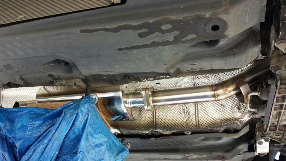

            Hey Andrew, I went and saw Scott and he did my exhaust system too. Its not fully complete but its almost done. Im doing a 2.5" system instead of 3". The varex mid muffler was able to fit perfeclty exqctly in the middle under the car. No clearance issues either.

              his welding looks pretty damned good, not that common anymore
