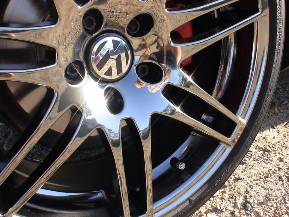

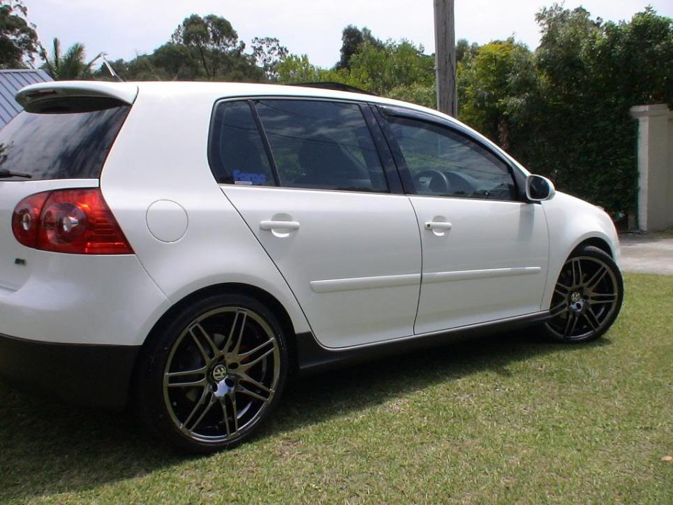

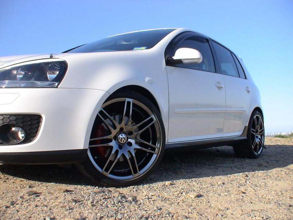

                              19"x8.5".ET+48. RS4 Reps from Velocity motoring in the US. Landed cost to your door is less than AU$1500.00. Fitted with Yokohama Advan's 235x35. @ $130.00 each. The Facts: Pros;improved handling, smoother acceleration and stick to the road like the proverbial S--T to a blanket...Cons; rim rash and chips if not careful and can give minor rub on undulating corners at full WOT.
