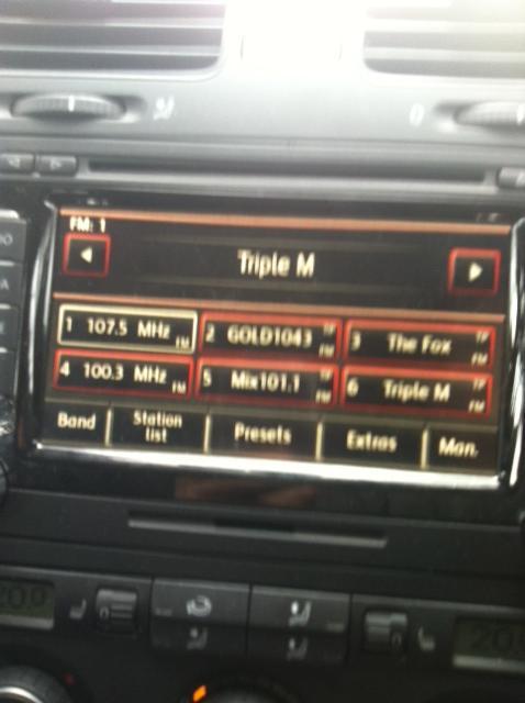

                    This has been happening to me as well....
                    It's very random, and it seems to change to Triple M or Gold FM shortly after starting the car, (maybe 400m down the road).
                    As you can see in this pic, I have turned on my car whilst on 107.5, driven 400m or so, Triple J is selected (107.5), yet its changed to Triple M, even though 107.5 is still selected (white).
                    Any ideas
                      Mine occasionally does this too. Just wondering if it has something to do with the TP broadcast on the stations it switches to. Even though it is not ticked as active, it only seems to go to the channels with the TP broadcast.
                      Graphite Blue TDI| DSG | Leather | Bi-Xenons | Custom LED inner tails | Black Forest TAI | OSIR Pod & New South Boost Gauge | Bluefin | Projector Fogs | RNS510 | Skoda Bluetooth | Eibach Pro kit Springs| Full LED interior|US GLI paddle shift MFSW|Carbon Vinyl wrapped trims|Colour Coded Votex Body Kit|
                        This could be happening if the RDS is set on. Here, the radio can automatically look for another frequency for a station with the same name. If it cannot, it may default to the first programmed station.
                        If you turn the RDS feature off, then you will lose the station name, but it should disable the automatic frequency search.
