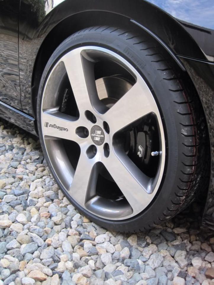

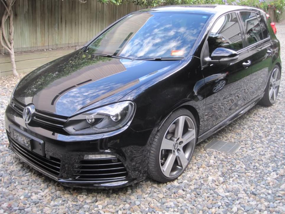

Do you have any pics? Do you rub? How low are you? Have you had your guards rolled? Ineed to give the specs of what I want my new wheels machined to... so thanks for any info!!
as per every other mk5 on here.
19x8.5et45 225/35, will rub depending on height and how you drive
could prob bring it back to 8.5et47-48 without any issues on the inside
