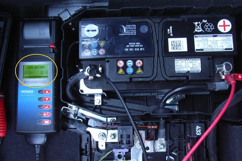

                • #23
                  I'm sorry mate to hear that you have'd so many troubles with your TDI. I have the tester that tests most sensors in todays cars, I can test the ignition coils as well. If you like, you can send the sensor to me, I will test it for you and you pay just the return postage.

                        Yes, always start with the basics first. When it comes to testing the batteries I don't guess, the guesses are costly and waste too much of the productive time. I use the Midtronics to test the batteries, starting system and charging system. It's very accurate and reliable. Downside is its price, but I'm happy to have it and would certainly buy it again.
                        Some battery chargers also offer some diagnostics capabilities, so if you're on look out for a new battery charger? This one is worth to consider Smart Battery Charger - REDARC
