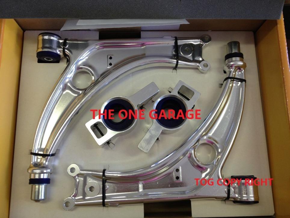

          • #20
            Here is a couple images comparing the supapro to the passat arms
            SUPAPRO
            PASSAT ARMS

              To be honest, i was dissapointed about this when i found out what i had really purchased. Especially seeing it was done by an aussie company that seems to have worked no differently as a dodgy Chinese company doing a rip off.
              Performance wise, yes the steering is lighter, and this is what got me worried when i compared this to all the reports on the WALK. The WALK actually makes the steering heavier, supapro makes it lighter, i have also found when compined with bilstein sport shocks and h&r sport springs that the car doesnt seem to like bumps during cornering aswell, i am thinking that this is more due to the polybushings taking the shock and transfering this energy straight to the chasis instead of absorbing this in the bushings as in the case of the old rubber bushings (i have had the suspension set up for 2 years before installing the supapro alloy arms).
              Overall, not to happy with it for a number of reasons
              1) its a lie, all it is are passat r36 control arms that have been polished.
              2) it is not an anti lift kit
              3) the polybushings seem to have made the car upset on fast rough corners
              Dont recomend them
              I would say for people to go the tt kit.
              And save your $520

                        I have personally been involved in the development of these arms from day 1, so might be able to add a bit of insight?
                        The arms are imported, they are an OE casting & they come in the "bright" coated finish, they are not polished at all.
                        The bushes are cast / poured into the arms in Moorooka, Brisbane.
                        The design of the rear bushes is similar to other "made in Asia" Gold & Yellow "Anti Lift Kits", they add approximately 1.5 degrees of static castor.
                        Unlike the "Anti Lift Kits" listed above, we don't have bushing failure due to the high lateral forces splitting the rear bush. There were multiple design changes to overcome this, and all tested on our APR Australia cars on the track & street. An example of the testing is some versions of "Anti Lift Kits" wouldn't last 20 laps of QLD Raceway with braking forces of the National Circuit. They have also failed on VAG cars competing in Targa Tasmania.
                        There are now also adjustable ball joints that work specifically with these arms that allow us to achieve an extra 1.5 degrees of negative camber.
                        These ball joints are included in the Harding Performance version of the arms (RR $750).
                        Summary:
                        They are an OEM VW / Audi arm, they are not "polished"
                        They do have "Anti Lift" bushes in the rear
                        They do have harder bushes in them so you may experience different noise & vibration to stock arms
                        They have harder bushes in them, so you do get better feedback & response.
                        Like all suspension changes, a good wheel alignment is critical, you can throw all the suspension parts you like at a car, and be let down badly by the wheel alignment.
