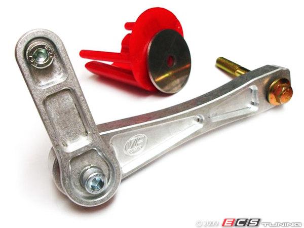

    I am going to a nut and bolt shop to grab a replacement bolt to get the car back on the road but in googling this problem I have come across these from ECS:
    Volkswagen Golf IV 1.8T > Drivetrain > Mounts > ES#5669 Ultimate Dogbone Mount Kit - ECS198851M
    Are they compatible with a MKV TDI? I think I have read before the factory 1.8T dogbone cn be used as an upgrade for the MKV TDI - just cant find anything to confirm this.

    Sorry Dan, totally different design, ECS has the VF engineering billet one, but you'll notice Tim at Dubaddiction has the BSH billet one cheaper....
    Volkswagen Golf V 2.0T > Drivetrain > Mounts > ES#6175 VF-Engineering Engine Pendulum Mount - VFA06-01
    BSH Billet Pendulum Mount [BSH-MKV-BPM] - $179.00 : Dub Ad·dic·tion [duhb uh-dik-shuhn]

      Hi Greg,
      Thanks for the info, ended up getting on the ECS live chat and as you said the one I was looking at is not compatible.
      Is the one from dubaddiction a direct replacement? It is not listed in the compatible cars.

            PM Tim and ask, but I don't see why it wouldn't be. It's what I would buy.
            Interesting about the idle vibration, and I think that pertains to direct engine mounts more in the Golf platform, as I have the APR Stage 1 insert in ym pendulum, and it made zero difference. I know Scotty went Stage 2 in his polo TDI and now he gets a full body massage at each set of lights...but the polo platform is an entirely different setup.

              In regards to upgraded pendulum mounts on diesels. Everyone has differing ideas of what is acceptable and what is not. The entire BSH pendulum mount is engineered to firm things up without adding much vibration at all on a Petrol engine. Perhaps we need a guinea pig to see how it goes on a DSG equipped TDI.

                    The link you posted is for a MK4.
                    Here is what we offer for the MK5 -
                    Volkswagen Jetta V TDI > Drivetrain > Mounts > ES#6175 VF-Engineering Engine Pendulum Mount - VFA06-01
