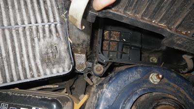

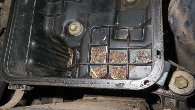

      Also check your air filter I can see on many cars that they make a nest in the air filter box and snack on the air filter element. I installed extra screen from the old filters at the front of the intake to stop the rodents from getting in.
      ...when they get thirsty they go and chew on windscreen washer hoses and overflows from the radiator, so watch out.
