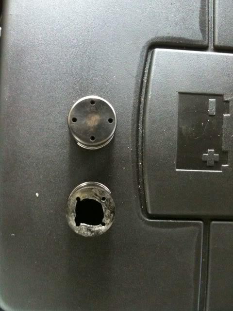

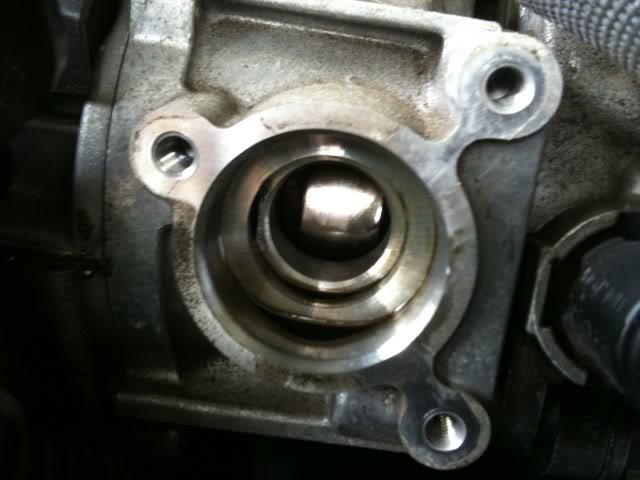

Are you hearing this??? The Gti has a high pressure injection system and is noisy as a rule. Now have checked a couple now and found the following, , just look out for it

Chewed out camshaft
Chewed out follower.
Ill update when i fit new cam and follower.
