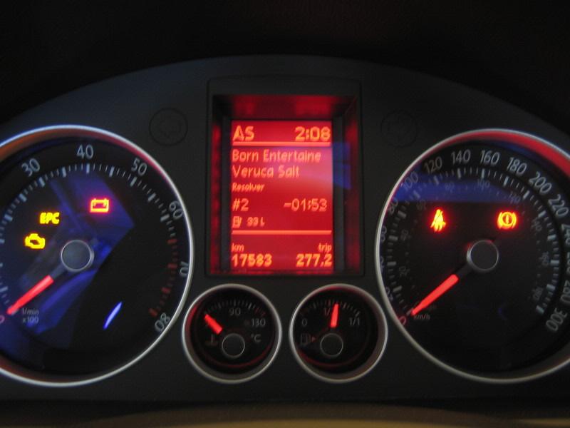

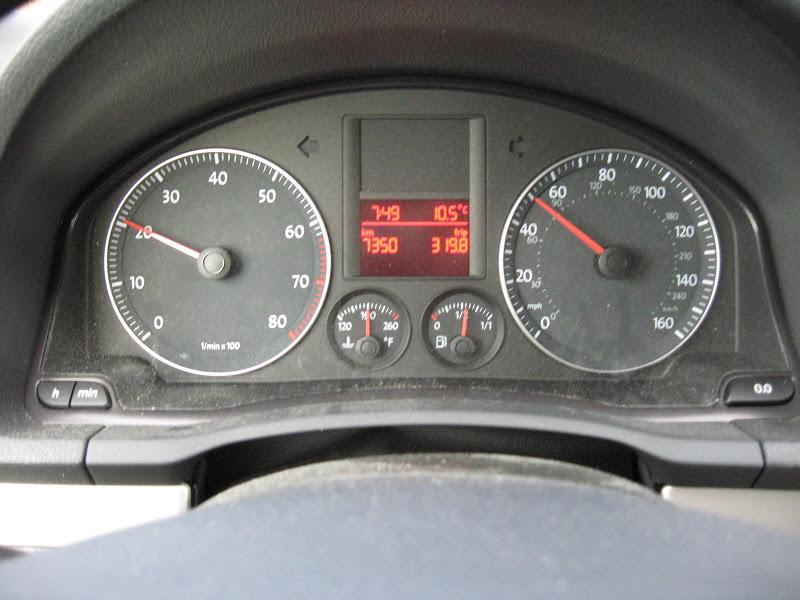

        It will change from the trip computer, to audio controls, etc but won't show the convenience menu.
        Full MFD
        Half MFD

          Yeah I have the half MFD.

            I've got the full MFD in my car, so haven't really played around with the half, sorry. I only know about the menu availability thing from previous research. With mine, single quick pressing the menu button will change from trip computer, to audio menu, to convenience settings. I'm not sure what yours will do sorry. If yours can change to show the audio menu then you can change tracks with the up and done.
