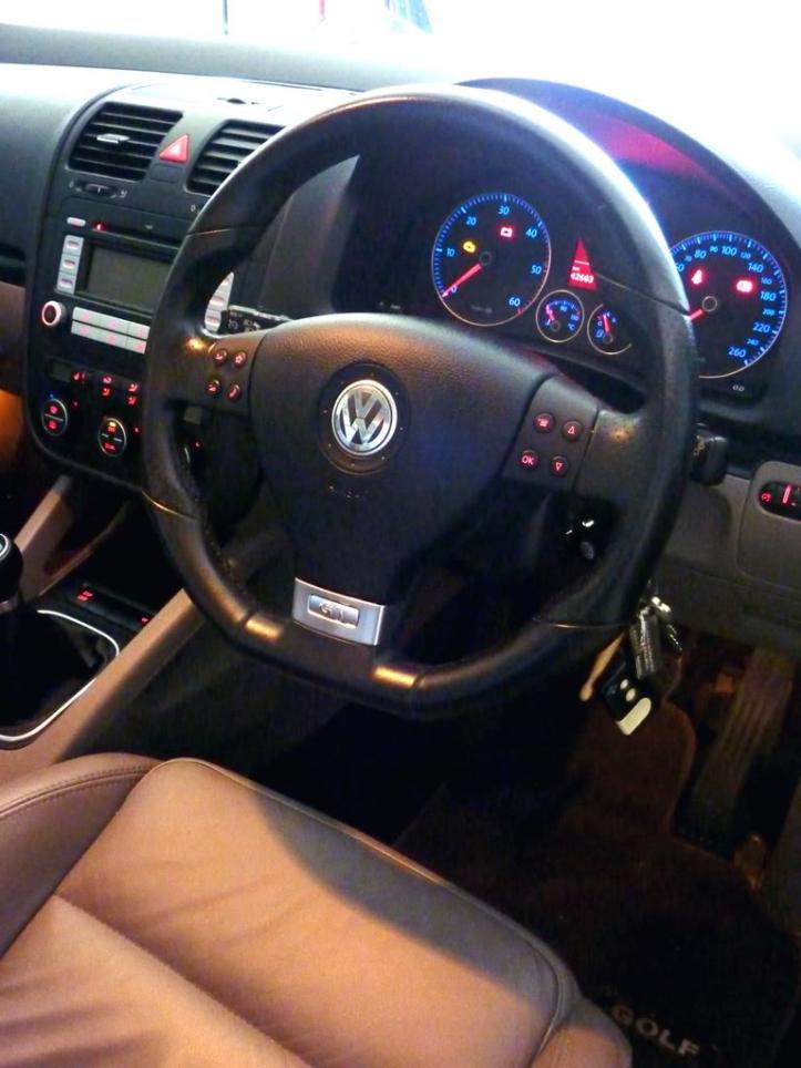

My GT has buttons that look like this ( The buttons are seperate from the surround -Originally posted by vspec2 View PostDo you have any pics? I thought the buttons where the same unless your GTi wheel is a US version maybe?
To be safe I would swap the buttons and wiring harness over from your GT if the buttons are different.

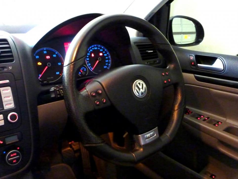

Whereas the GTi Wheel looks like this ( buttons and surround seem to be one piece )
Do you think its possible to just transplant the buttons?2007 Black Magic VW Golf GT TDi, Latte Leather, Sunroof, Bluefin Superchip, 18" Detroits, APR lower torque arm insert, APR Carbon Fibre Cold Air Intake system, GTi sideskirts & front lip, R32 Rear Bar, GTi Steering wheel, RNS-510,Infinity BassLink Subwoofer,stubby antenna, R8 Oil Cap, Golf R front calipers, slotted front rotors, ceramic brake pads, LITEC LED tail-lights, Dension Gateway Five, Rear Emblem Reverse Camera, H&R Ultralow coil-overs, Badge-less front grille
Ah I see the style of the buttons are different I was thinking you had completely different symbols or functions on your buttons. Just use a torx bit on that silver screw to the left of the menu button. It will come away unplug it and transplant it to the GTI one. Do the same on the other side.
CheersMY11 Golf GTI | CSG | DSG | DG| HID | RNS510 | DYN | P Ass | LTHR | SR | RVC | R LED | Tint
