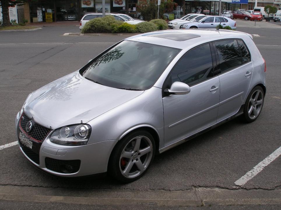

    I'm just about to organise the purchase of a Golf Sportline for my girlfriend in Adelaide. It already has 18" R32 wheels fitted, but no wheel arch wing extensions - which according to all the Mark V golf brochures are mandatory when fitting 18's.
    We live in NSW, so the car will need a blue slip before it can be registered in NSW. As you can see from the photo below, the wheels currently stick outside the wheel arches. Do you any of you know if the wheel arch wing extensions will need to be fitted? Do you any of you have them fitted? Do any of you know how much they cost? My understanding was that in NSW, wheels/tyres couldn't sit outside the guards.

    Here is a pics showing the extetion on the front guard.
      If it really bothers you, I would weigh the cost of acquiring these OEM parts, prep and paint to match your car versus minor guarrdwork. They don't poke that far and as you can see above, they look hideous.
        I have 17" Audi TT rims that will be pretty close to the same distance out, maybe a shade inside it, and I'd say you won't get 2 looks at it - I don't.

                    Pretty sure I've seen the car around, first thing I noticed was the R32 18s poking out the guards
                    I reckon they must be replica wheels due to the offsets.

                      Actually you do need the extension winglets to legally fit the 18 x 8" karthoum wheels.
                      Volkswagen have a better idea as to what is and isn't required to sell a car 'legally' in this country.

                            The question is Silver Dub, do your wheels sit outside the guards?
                            If not, then no worries...
                            But If so, when your car finally gets 3 yrs old and needs a pink slip (provided you're in NSW and not some dodgy state that doesn't require roadworthies) you'll find that unless the mechanic is dodgy, your inspection will be failed. Even more annoying would be getting pulled over at an RBT and the police officer going "nice rims, here's your defect...". Or the worst scenario, you have an accident and the insurance assessor notices your rims are outside the guards and denies your claim. These are all the things I'm concerned about. But I guess we'll just see what the blue slip place says about them...
