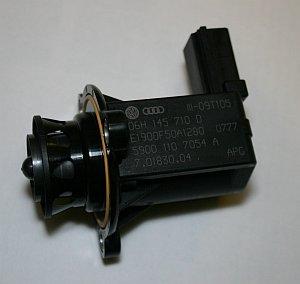

    The best one to go for is the newer D revision OEM piston style DV. It performs just as well as the aftermarket ones and is more reliable than the older diaphragm type
    You can see the part number on the photo. Dealer charges anywhere from $150 - $180 for them. Ive sold out but should have more stock later next week.

              No more pissy diaphragm and its electronic so instant response as opposed to say a Forge mechanical unit. I think its from an Audi. I know a bloke who races a 215fwkw GTI with the same unit for over 12 months now.
