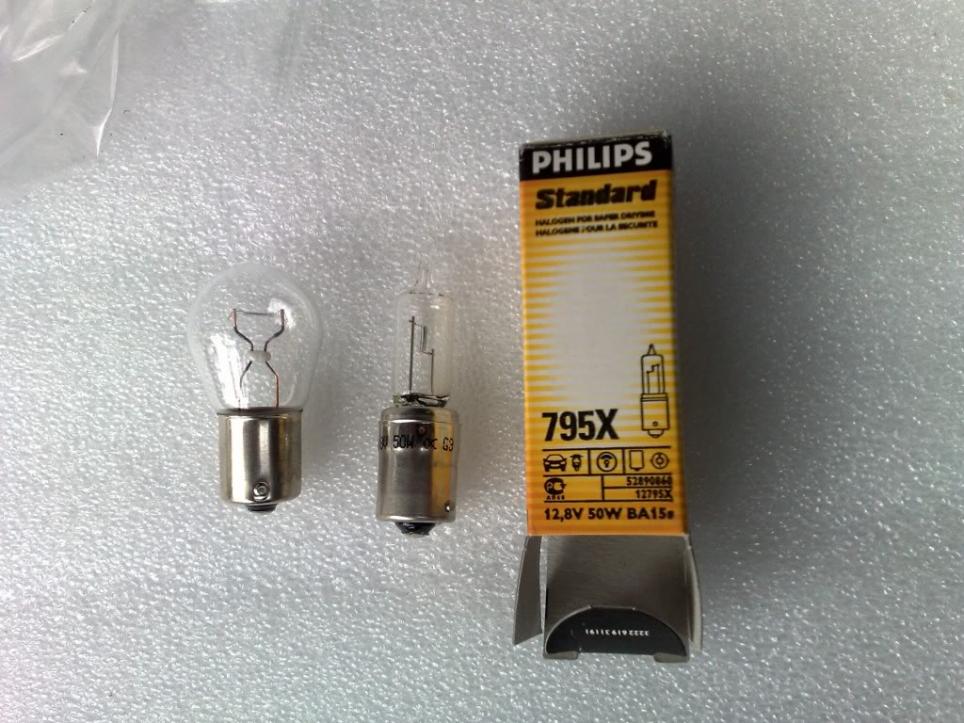

A few have wanted brighter rev lights.
I have just fitted an 50w halogen direct replacement.
No bulb out warnings etc.

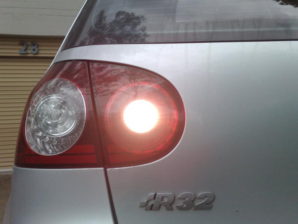

It is a bit brighter than the 20w standard one but not as much as I hoped for. Any gain is good thought. Prob isnt getting full voltage due to lower resistance.
I dont believe there will be any heat issues either as bulb is not on long enough to heat surrounding areas. Its also amazing how hot the standard bulb gets too.
Cost about $11 from Autobarn etc.
