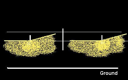

                    Here is a general link for "laymen". Just swap cutoff to left for RHD cars.

                      Perhaps we are talking about the same thing. In the following pic from your link the lights seem the same height but the area on the road looks like the RHS is lower if you look between the two vertical lines..
                      Wasn't doubting you, just seems like my drivers side light could be slightly higher but would probably start 'getting flashed' by other drivers.
                        Shouldnt make any difference to other road users. From a distance both lights become one so height is not the issue.
                        When cars had to old style oval beams without cutoff it was different.
                        'Z" (VW projectors and zenons) beams and "Y" (Halogen) beams are set in the same plane.
